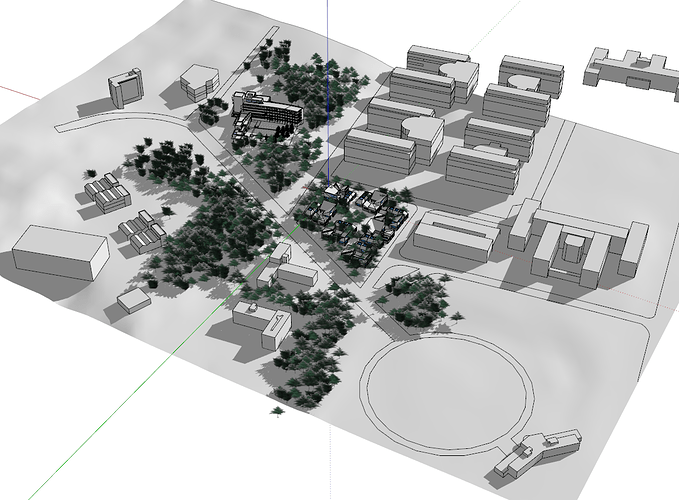

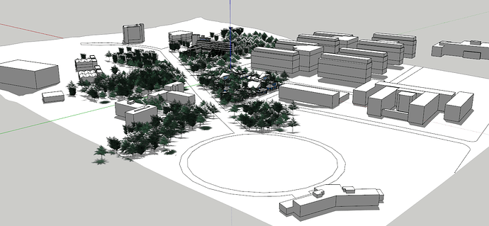

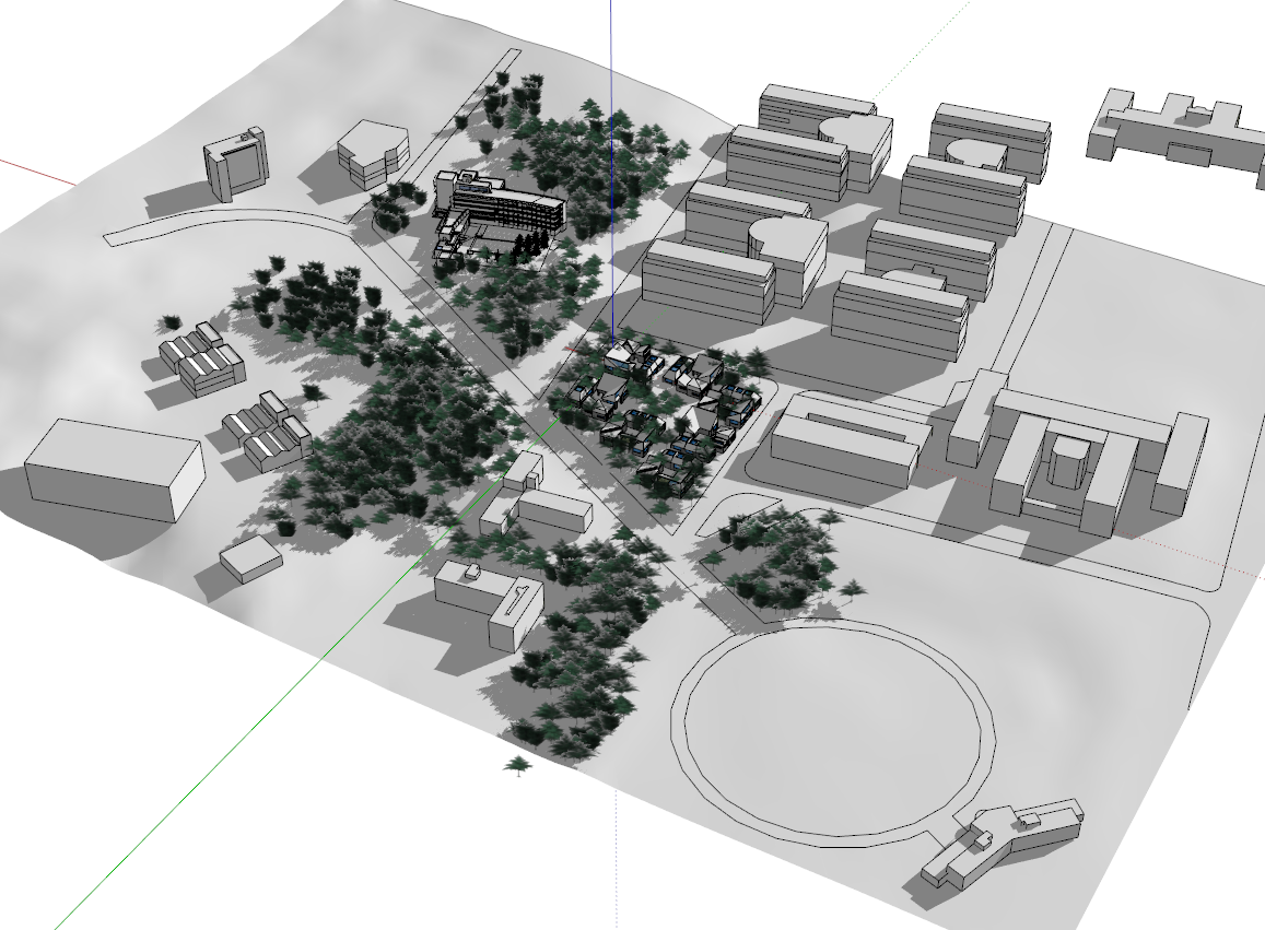

I have Sketchup 2017 pro and I have models that was imported in from 3d Warehouse and the shadows they cast are lines only but the model I created is fine. Some aren’t casting shadows at all. They are all checked to receive and cast shadows. They had previously worked when I had Sketchup 2015.

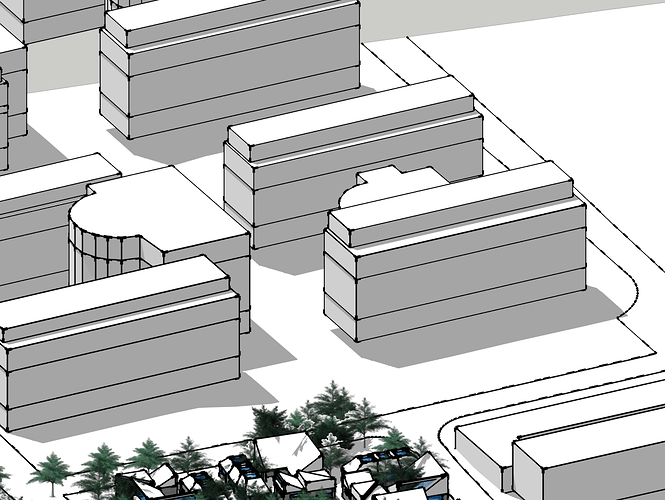

That’s strange. I expect something has been corrupted. I copied all of the model to a new file and the shadows from the buildings are displayed as one would expect.
FWIW, Shadows from edges aren’t especially useful here because there aren’t any edges without faces.
Edit: I’m not sure what it is about the material you used on that terrain but after editing it in your file, it started showing shadows as one would think.

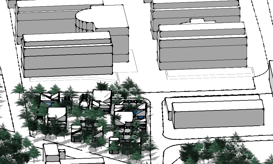

When I switch on layer 0 in the file the shadows appear? The buildings appear to be floating above 0.
Good catch.Part of the incorrect use of Layers.

One thing I had also done before that which may have had something to do with it is I repaired the incorrect layer assignments for the edges and faces and set Layer 0 as the active layer which it should have been all along.
