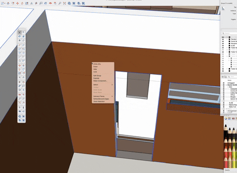

Hi! Hoping/assuming there’s a super simple solution I’m not seeing here.
I’m drawing guides over grouped walls (pictured). Even though I’m not within the group (IE not “editing the group”) when drawing these guidelines, the guides seem to get “lost” in the group, meaning I cannot select or use the guides. The only way I can select or snap to these guides is if I Hide the group, which makes it not very useful.
Thoughts? Seems like this should be pretty straightforward. Thanks!

However, the most confounding thing is simply being able to select the guide. I don’t know how to upload GIFs here like people do, but you’ll just have to trust me: if I click right on the guideline, nothing happens. it does not become selected. even if I open the wall group to edit it (IE, select the faces within that group) I cannot select the guides in that layer either. As stated in the OP, the only way I can select or manipulate those guide lines is by hiding the wall group.

a further bit of evidence for the case, if I click the end points, I “select” the guideline. however I still cannot click the guideline itself as I can elsewhere. my hunch is that because the guidelines are placed “within” the wall group (even though I drew it on the “face” of the group), when clicking the guideline, it thinks Sketchup think I’m just trying to select the group. But yeah, for whatever reason it is still letting me select the endpoints of the guides, which is better than nothing.

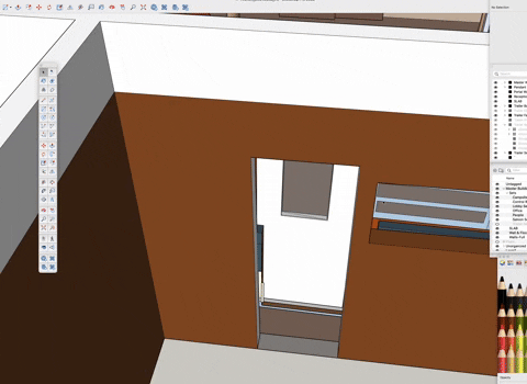

Hey everyone! For everyone who claims I can only select this line/tail by selecting the points, watch me select it by clicking on the line.
Now, as stated in the OP, I can only select it once I’ve hidden this group. Why? I can clearly select the line, and this is how I’m used to selecting Guidelines always, just not when this group of walls is active.
Hope this GIF (I figured out how to make one haha) helps clarify: (sheesh, can’t figure out how to get the embed code to work but it’s here: - Find & Share on GIPHY
EDIT This gif cuts off before it shows me selecting the guide line by clicking DIRECTLY ON THE LINE (after hiding the wall group)

Part 2: where it shows me selecting the same line once I hide the wall group: Part 2 of GIF

To answer your question, Yes you can select a tail, but it is not easy and will generally be overridden by the group. You can use a selection fence around the tail including the point and it will select without hiding the group.
You can see here how the move tool will hilight the group until you get to the guide point. And clicking on the guidepoint works but not the tail.

Hi Box, thanks for this! Very helpful. Yes, drawing a left-to-right fence selecting the whole tail is one way to select it, though obviously often times a tail can grow to be quite long and/or depending on the positioning, difficult to draw a fence around it without selecting other things. this is why often times I prefer to simple click the tail. But you’re right, as you’re pointing out, if the tail is along the face of a group, Sketchup prioritizes the group selection. I guess it’s just a quirk I’m going to have to work around.
