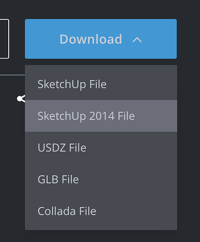

For interest, here is an example of a model that was uploaded as 2014:
Its download menu looks like this:
The SketchUp 2014 File option does download the original 2014 format SKP.

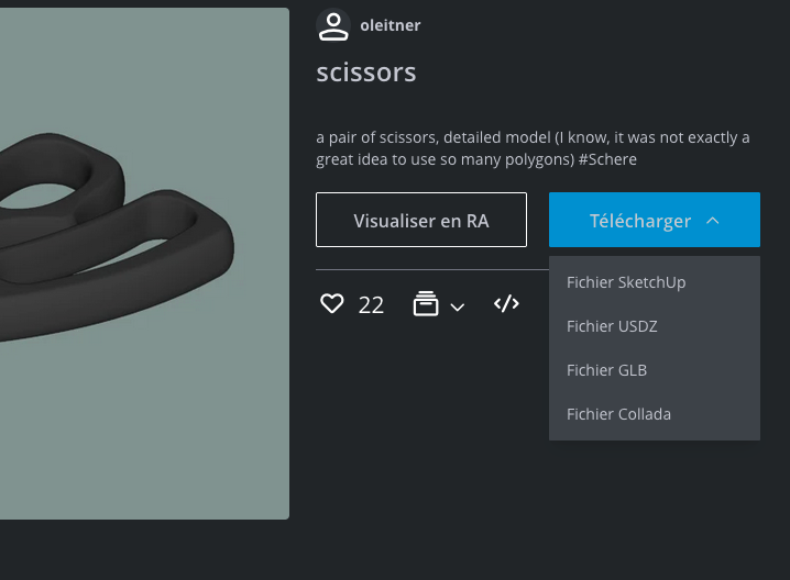

In the Filters section is a year slider, where you can set a range of years for when the model was created. Here are all of the scissors made before SketchUp 2018 was released:
They all have the option to download the original format SKP.

I wonder Colin if you can download that because you’re a SU employee, so you can get the original file.
because I’ve tried the scissors.
and none of them allows me to get anything but the versionless file.
I’ve checked the oldest files out there, same. just the SU21+ file even for a 2014 upload.
