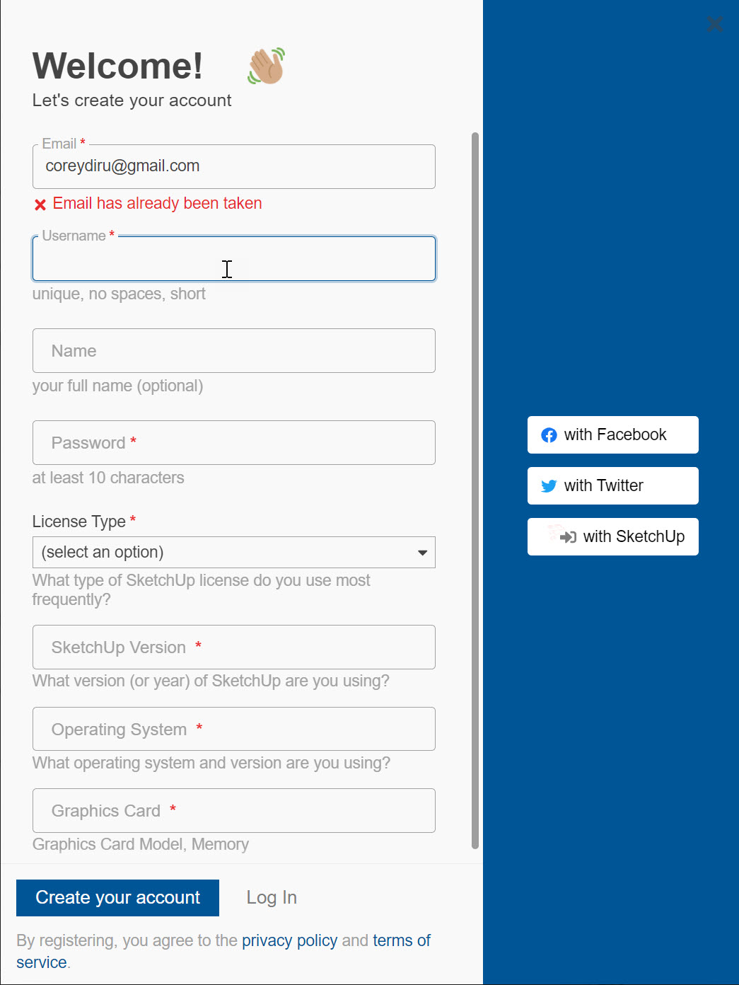

When I try to login to Sefaira, this is the Image I get. How do I fix this problem?
I have SketchupPro 2020 on Windows 10

That doesn’t allow me to login either. When I signed up for the sketchup studio trial, I did so with my google account. I encounter a similar log in issue when I try to log into the Sefaira web app - I have to “log in via sketchup”, and I’m unable to log in with the email address associated with google because its “already taken” thanks again
