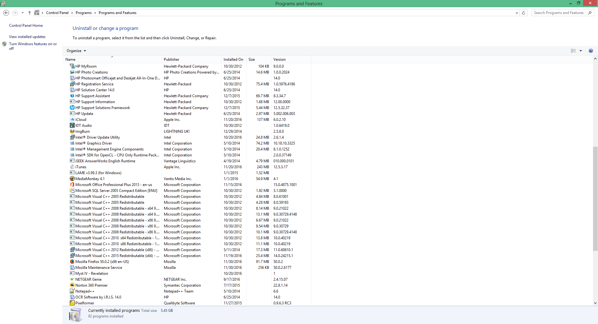

@usmma76 Could you post a screenshot of your system’s installed programs? I’m interested in which versions of the C++ libraries are installed.
Thanks, @usmma76 .
It looks like you have the correct version of the C++ redistributables installed.
