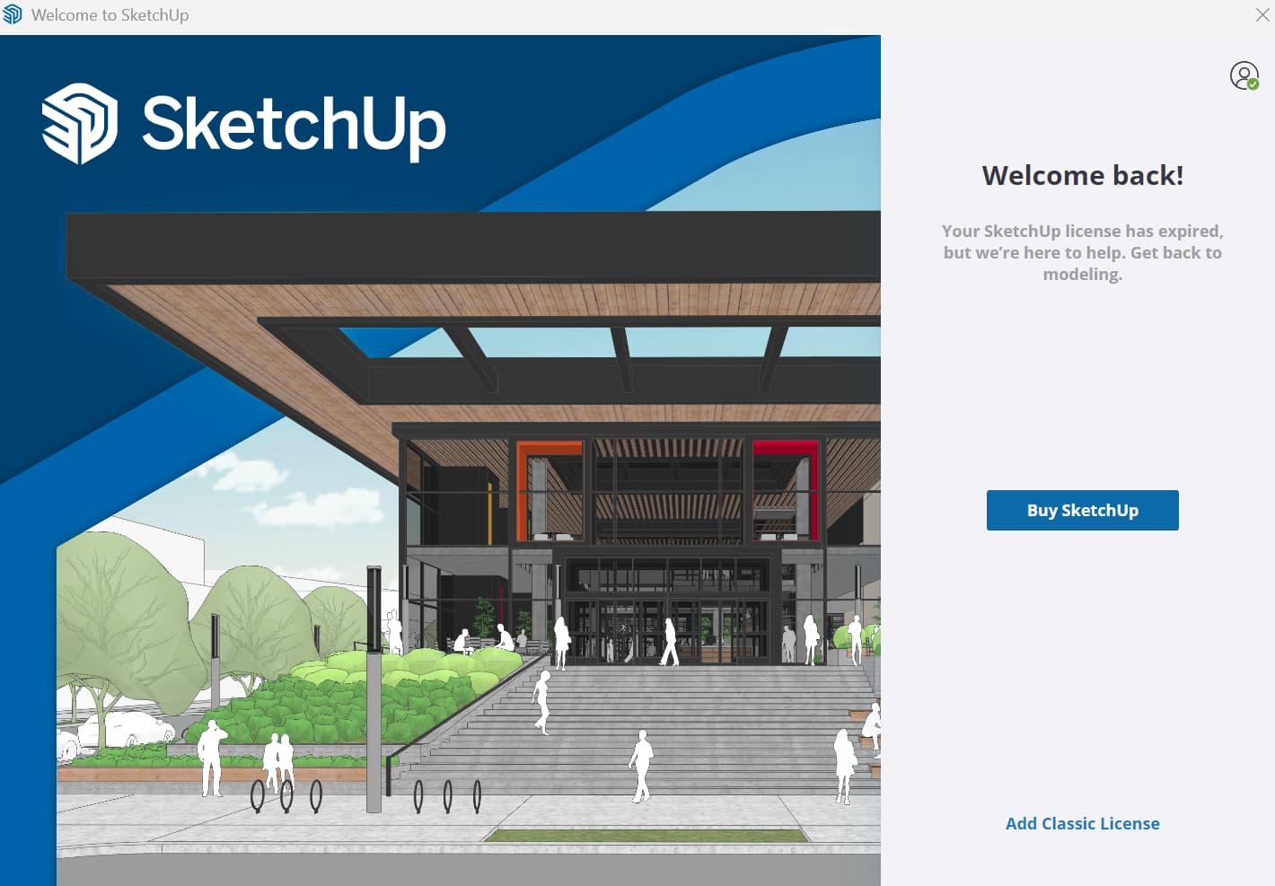

I recently purchased the subscription plan for Sketchup Pro, but when i try to log in

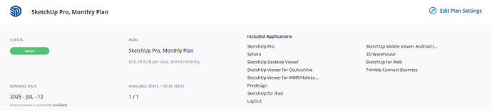

showing that my license has expired. However, in my trimble account, it shows that my license is active.

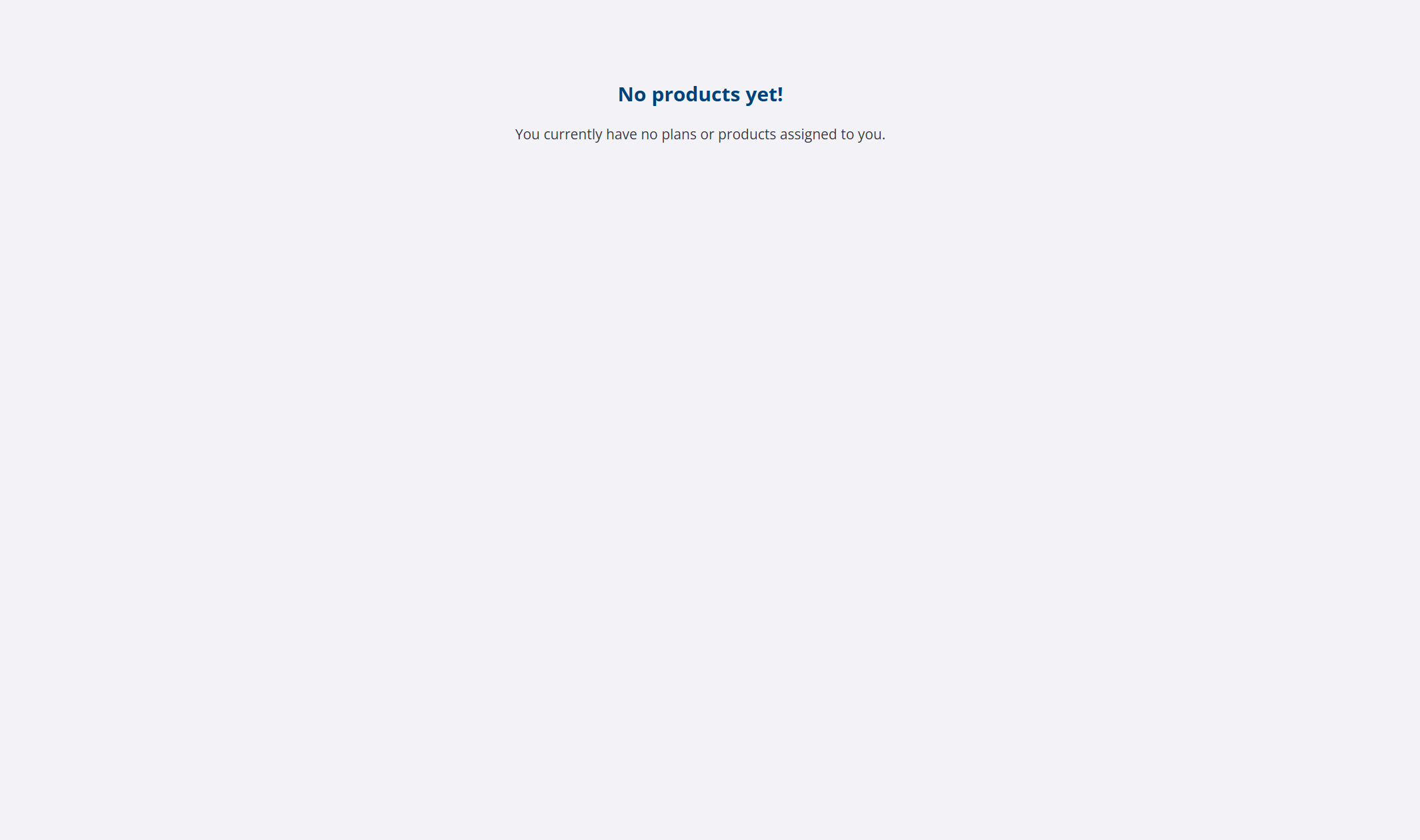

I do not see any products. Why is that?
I don’t really know, probably @colin can check your license.
You haven’t assigned the license to yourself.
Which is why you have 1/1 subscriptions available.
Assign it under “members”
Here are the instructions from the sketchup website
https://help.sketchup.com/en/accounts-and-administration/account-management-portal
On the left of the management page is an account menu. For your email address there are four accounts. The one with the monthly subscription listed is the one with the initials V E. That is the one to select, and once you’re looking at it you would go to Members, find yourself in the list, and click on the three dots at the end. There you can modify product access, and make sure you’re allowed to use the monthly subscription.
