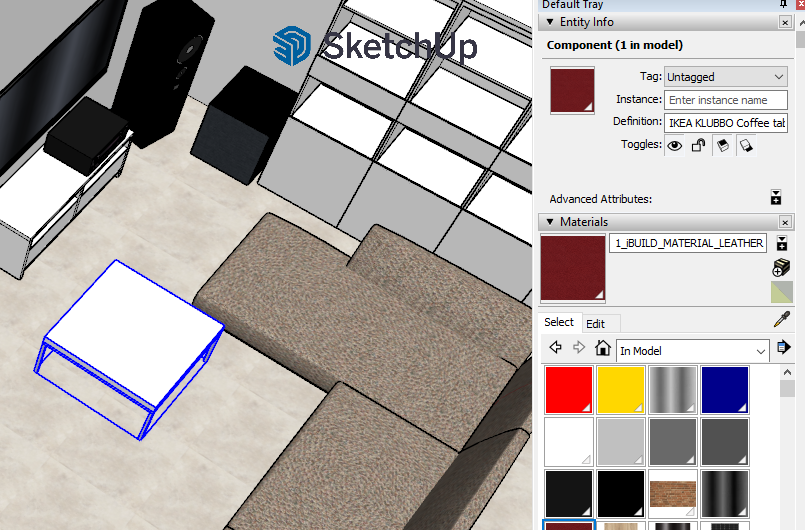

It took some searching but it is applied to the IKEA KLUBBO coffee table. It’s applied to the component instance while the faces inside have their own materials so the material applied to the component container won’t show.

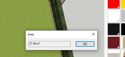

It also seem to be applied to something else although I haven’t found it yet. It covers a little more than 21.5 square meters.

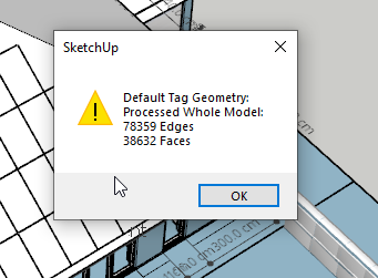

There’s quite a lot of incorrect tag usage. ALL edges and faces in your model should be created and remain untagged. Only components, groups, and dimensions should get tags. The result of fixing that:
