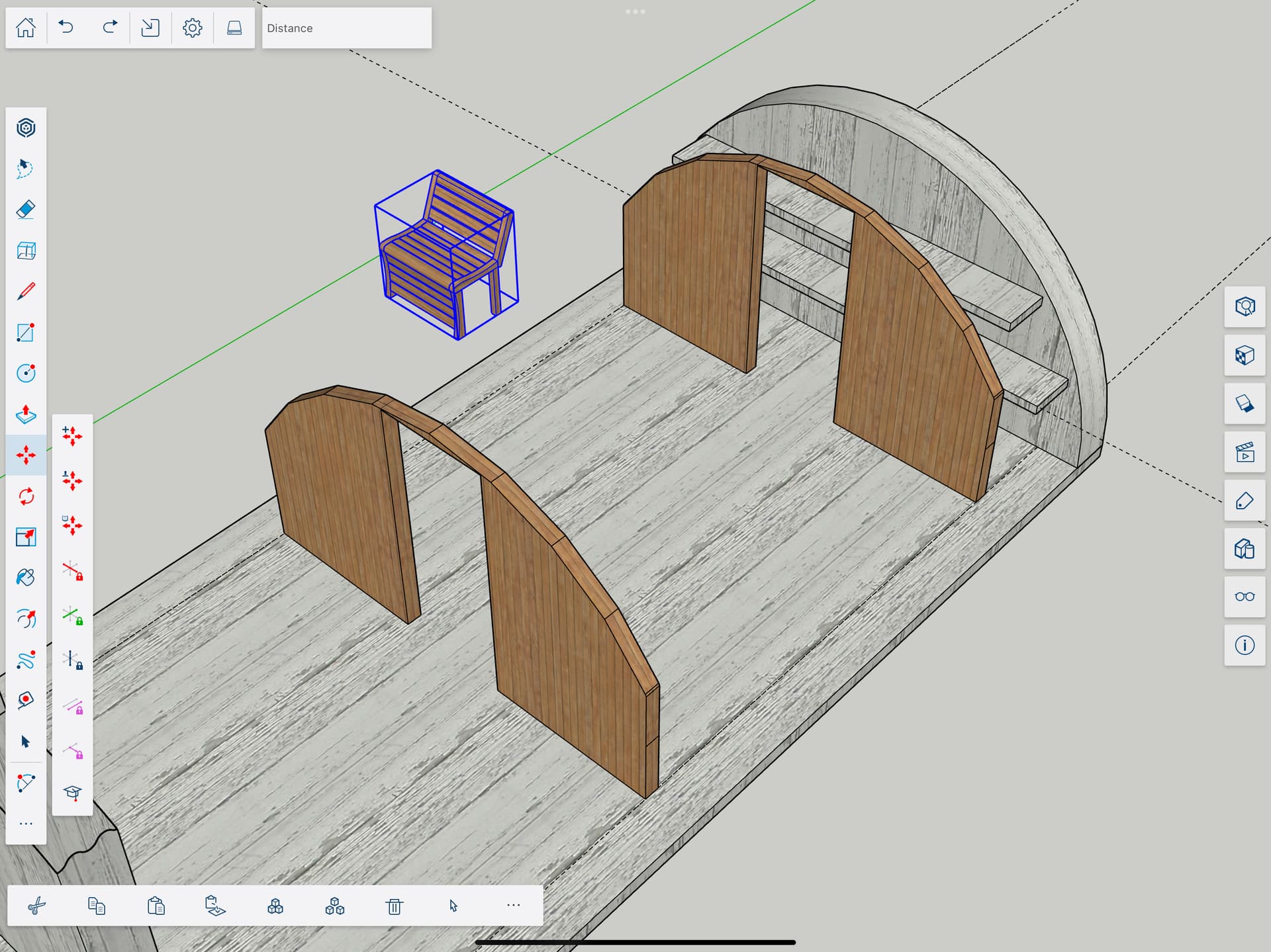

The bench file you uploaded isn’t the one in the video, I don’t think.
But it has bad tagging in it, you have tagged the geometry not the group/component in some cases.
Possibly the file you are copying into already has a component with the same name that has the seat part missing. Copying and pasting won’t overwrite existing component definitions.
Honestly, I just attacked it with force. …. So I’m not sure.
I went into the benches model, deleted ALL tags, sending everything back to untagged, then I exploded back down to base geometry and regrouped the whole thing. Made a component of that and changed the name to “single bench 2” when it whined that there was already a “single bench” component.
BUT! Your gif there shows that I could have just turned the bench tag on in the sauna model to see it? Which is a fascinating case of ill-behaved modeler! The client is returning to the original bench design, so I went and grabbed them from another file, which had originally been copied out of the the very first sauna model (about 4 renditions ago) … but this sauna model is retaining component info from that one, and then benches were in that somewhere and tagged as ‘bench’ which… ■■■■. Should have just started over. HA!
This is fascinating, because (and I’m agreeing that it is user error) the “Swedish Benches” are a totally different set of original geometry, totally different bench. But SketchUp is trying to organize my copy/paste for me?
Edit: nope. I see it. I had a migrated tag in the new bench file. That’s totally on me.
I had this same issue once, and took me ages (or bit less) to figur out i turned off a tag, so that was the first thing i checked.
I’ts like “Colombus Egg”, sometimes the solution is so simple you miss it over and over again.
Anywho good you could fix it one way or another
