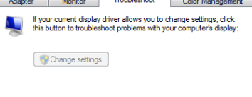

I looked up a few threads and they suggested turning of Hardware Acceleration. When I try to do this, the “change settings” button is greyed out which apparently means my current display driver does not allow me to change the settings.
I’ve also tried updating my graphics card drivers, rebooting my lap top, uninstalling and reinstalling all to no avail.
change settings

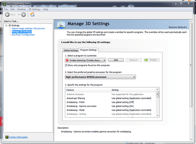

UPDATE: Fixed this myself!! Hurrah!!
Here’s how: I booted up the NVIDIA control panel, clicked “manage 3D settings” then selected the “program settings” tab.
Under “select a program to customise” I found that if you select the “Trimble Sketch Up” program, then change the preferred graphics processor to “High performance NVIDIA processor”, then click “Apply”, you can then boot Sketch Up as an administrator without it Bug Splatting.

This is a common error with laptops. With the default settings, Windows will choose to use the built-in Intel graphics chip instead of your Nvidia card (to save power, perhaps).
