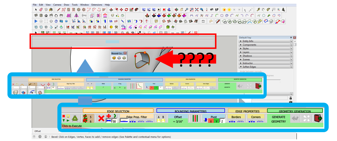

I reinstalled some extensions and after that the extension menu was not visible as a red mark. For normal display as a blue chart.

Update those extensions from Sketchucation. Also update LibFredo6 and the Sketchucation Extension Store tool.

Yes. You must use the latest versions of the Sketchucation Extension Store, LibFredo6, and any of Fredo6’s extension you need such as Round Corner.
Install the Sketchucation Extension Store first. The restart SketchUp and use the Sketchucation Extension Store to search for and install Fredo6’s tools.

I tried these instructions, hopefully the display will return to normal and my stuck be solved soon

After installing Fredo’s extensions, you must also restart SketchUp before trying to use them.
