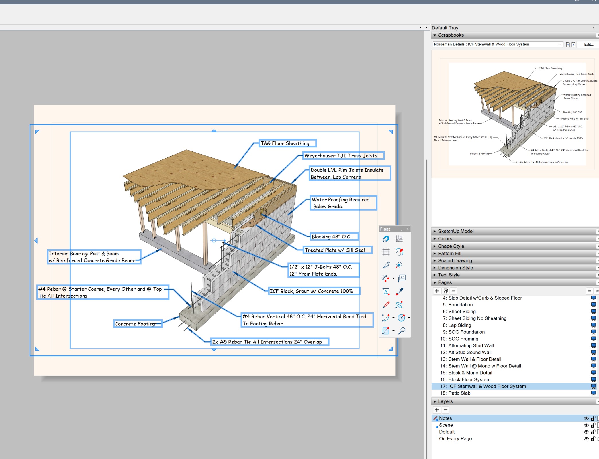

I have an ever growing library of scrap books I keep them organized by type. What I mean by that is I have symbol scrapbooks, schedule scrapbooks, detail scrapbooks and more. All are in a separate scrap book then within that scrap book are each specific part of the file. Scrap books can have multiple individual scrapbook items. When you edit this scrap book the individual files appear as a page in layout. While editing you can add a new page then import a SKP file annotate it name the page and save it into the scrap book. One tip is when editing that scrapbook “page” select all entities and group them, if you dont the labels, dimensions ect wont be visible.
In the image you see the scrap book detail being edited. its visible in the scrap book among the list of other details and in the page list. You see the SKP viewport and all annotations selected as a group. Once this is complete you save and close editing the when you want to add the scrapbook item to a drawing set its just a drag and drop like any other scrapbook item.
