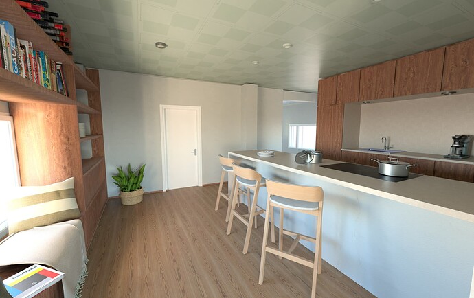

I played with the file for a time, too. Removed all lights that were not attached to a visible luminaire. Couldn’t get any light out of the IES lights so I switched them to V-ray lights. Render times on my PC were just minutes (with RTX rendering)
The model is mostly just loose geometry. Did some of it come from Archicad? (guessing from the tag names).
When testing on RTX 3080, the scene did load very slow and I couldn’t see anything as your IES files and dome light didn’t work.
  1. Reset all render settings;
  2. Turned on Material Override for everything, except glass. Still loaded slow, so issue was with lights, not geometry or materials;
  3. Deleted all lights, except sun and dome. After this render worked very fast
  4. Set Dome light to white color and power to 1000, set sun power to 1 and adjusted the angle to light the scene. Set scene exposure to 7 in Frame buffer
  5. Replaced ceiling color to simple white;
  6. Replaced Floor material, as old one didn’t work with RTX render
Result - 5 minute 4k render at medium quality:
