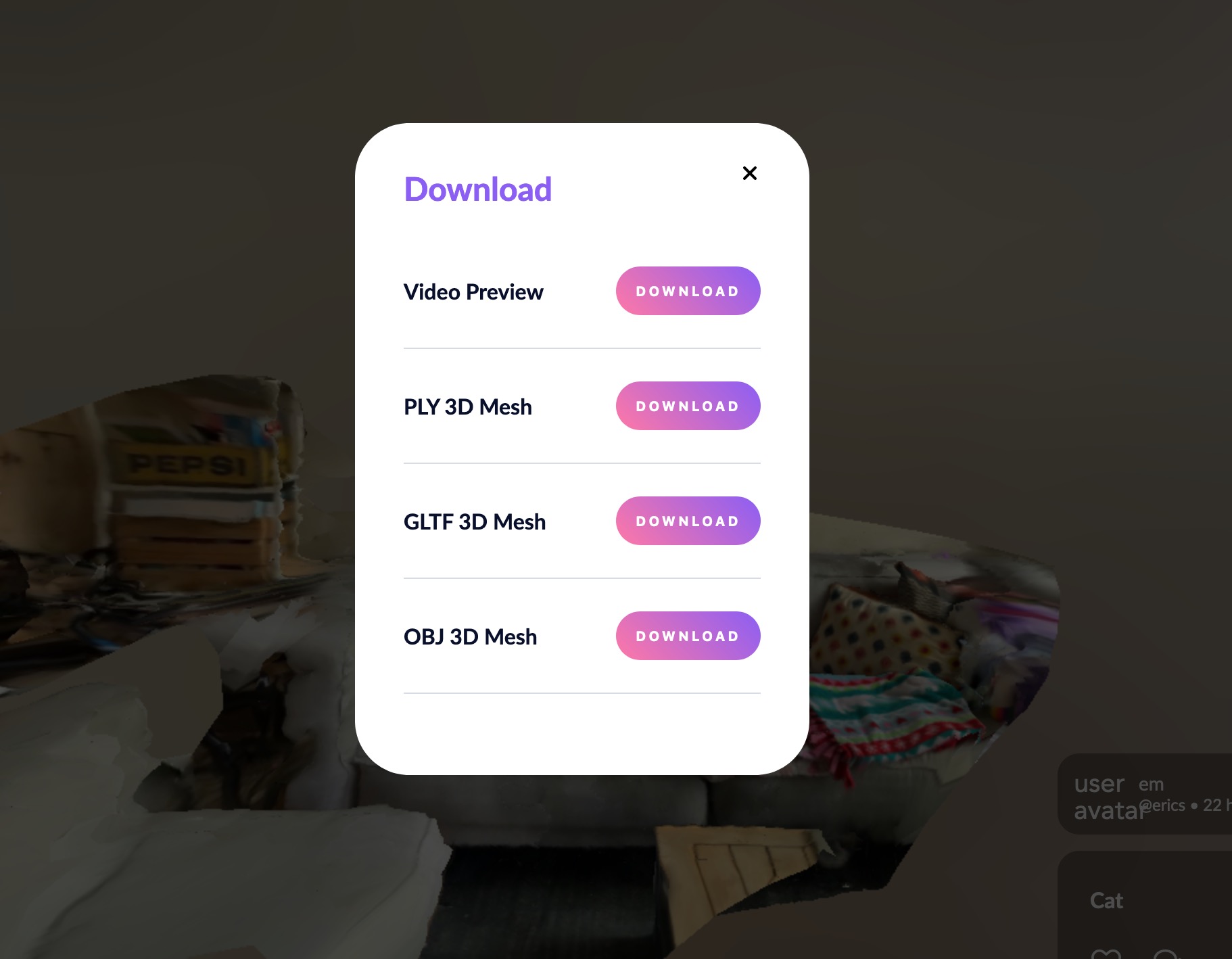

Hello, what was your import/export process ?
Not sure about Eric, but I downloaded the glTF data and used an extension to import that into SketchUp.
I saved it as OBJ and imported via Transmutr (now that they finally released a Mac version). :+1: Then saved as .SKP format. You could go through Blender if you’re looking for a free option as that’s what I was doing before. Or check out Universal Imported: Import 50+ 3d formats with Universal Importer in SketchUp - YouTube Which I haven’t tried yet. *EDIT: Universal Imported didn’t work for me. Will look into it.

I imported the .OBJ into Blender, then exported a .DAE. All you need to know is the import & export buttons in the file menu in Blender. Put the .DAE in the textures folder and it should import into SketchUp with textures.
