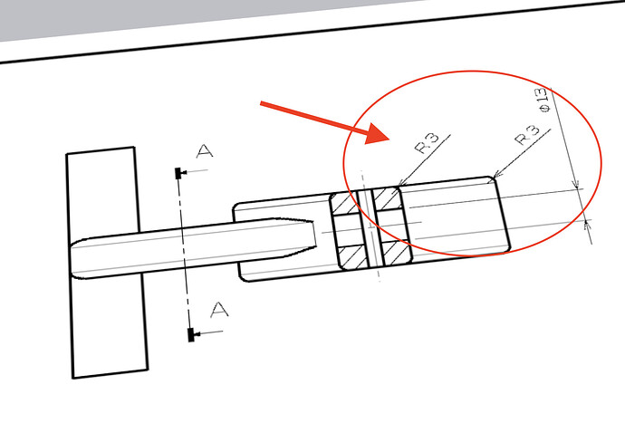

I would like to create the roundings as shown in images #1106.
If the corners at transitions are not too sharp it works fine with, for example, the extension RoundCorner or Bevel. But as soon as the transitions are too sharp I can’t manage to round them off properly. Attached also the skp file.
Are there any methods to make the rounding correct on sharp transitions? Thanks in advance for your suggestions
#1106_b.skp (557.3 KB)
