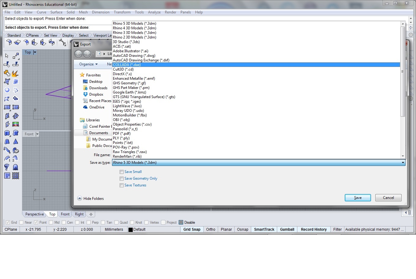

I had an issue with delivering STP files to a fabricator who uses Solidworks and Rhino.
I looked into Rhino, they have a 90 day free trial
Rhino will open and import my SKP files and export as STP, and many other file types.
My best results came from exporting as.3ds file out of SU,
opening the .3ds files in Rhino,
and then export or save as .STP (or Rhino file .3dm which provided them all options.)
Even better in my case was that they could use the exports from Rhino, which look and function well FOR THEM,
and generate their own STP files for mold making.
FYI I could never have gotten there without the SU CleanUp3 extension which dealt with my old files, and my learning curves!
priceless before converting to other file types.
As for free…I still have most of the 90 day free use of the full version I downloaded.
Rhino5 is very versatile, and was part of a good formula to get to STP for me but I will stick with my SU2017
That’s my offering…though not a perm. solution.
Cheers Roto
