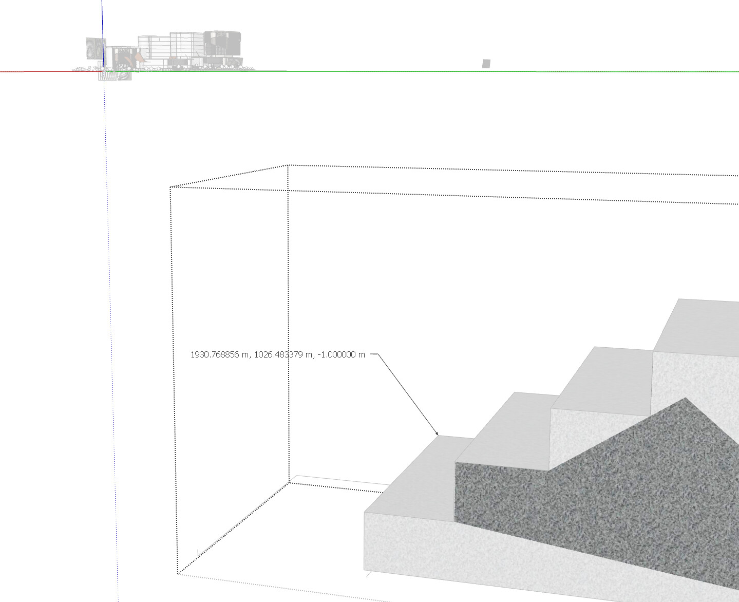

It’s kind of a mess. There are some bad objects which I’m still looking at. I wound up copying the rest to a new model and have this:
You’ve got quite a lot of the model is placed more than 3.5 Kilometers from the origin. I suspect that part of the issue with the bad components is related to this large distance.
I also note incorrect tag usage. ALL edges and faces should be created and remain untagged. Only groups and components should be given tags.
You’re also hoarding a great deal of unused components and materials.
After copying what wouldn’t screw up the new model there are objects at huge distances from the rest of the model.
I’m curious about how and why this stuff got scattered across the countryside.
Here’s the file without the offending components. I’ll see if I can do anything with them. I moved the distant elements closer to the rest of the model for you but they are still randomly placed.

The two main offenders are components called “facade1” They’ve been scaled without updating their component definitions. So far I haven’t been able to do anything useful with them. Whatever they are, maybe you could reconstruct them correctly.

I believe that “FACADE 1” is imported from Rhino. I just remembered that I was currently scaling the object then THAT happened
Try importing it into a separate SketchUp file and correct it’s dimensions if needed. Remember to scale the definition and the definition of each component nested inside it. Once you have it all correct copy it into your project.
