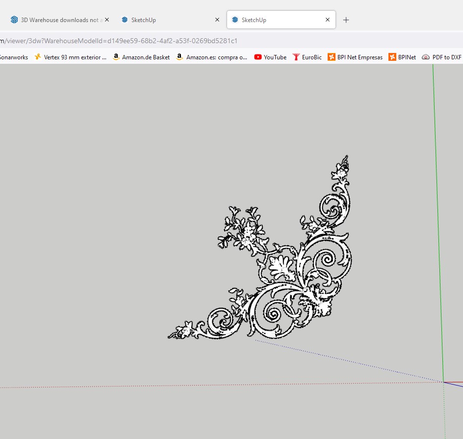

Hi There,
I am having the same problem as you did and have read the solutions.
However, I cant seem to find the .dae file extension to the model I wanted to import.
I have opened the 3d Warehouse via Window - 3d warehouse-- then searched for the model category I wanted (mouldings), then to the particular model I wanted. (see screen shots below)
Here is where I am stuck.
The download button does nothing, (as I was expecting) but I can’t see where to locate the .dae file for this model on this dialogue box.
If I click on the 3d model, I am diverted to the on line model, but I have no idea how to export or save that model so I can then import it into Sketch Up 2017 pro as a .dae. or any other file.
Can you help?
Many thanks,
Alan
You need to open the 3D Warehouse in your internet browser to get the Collada file. Hover over the right end of the Download button to get the options.
Download the Collada file which will come with the extension .zip. Open the zip file and extract the contents. If there are materials included there should be a folder along with the .dae file. After you’ve extracted the files, use Import in SketchUp to import the .dae file.
I see what you are saying. It no longer works for me (nothing when I click download) from within SketchUp (Window) either. But when I go directly through the internet it does work, I do see an option for the Collada dae file. Then I could import it to Sketchup using the drop down list on import window. Been a while since I’ve used this…
It’s not supposed to work anymore.
Many thanks, Dave.
Seems to be working.
