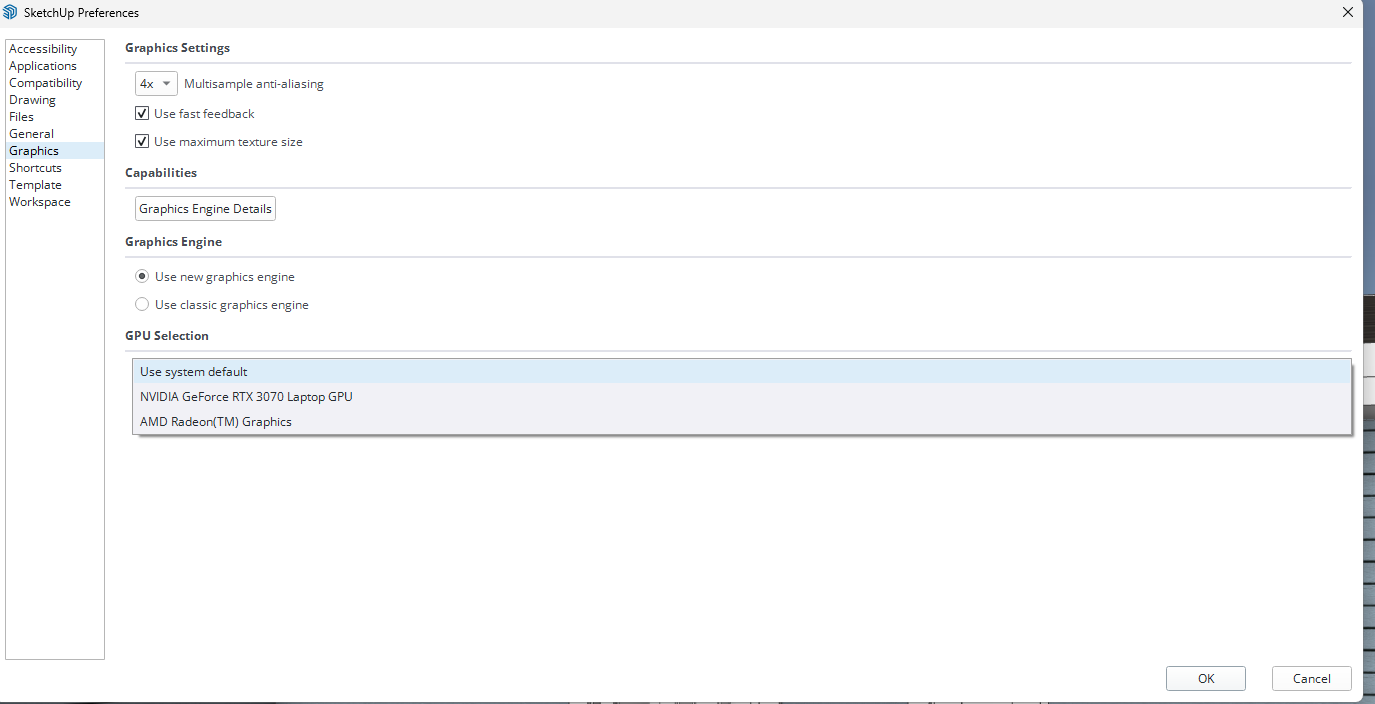

I updated my graphic card driver and the problem still persist .
is this the right settings
As I wrote 4 hours ago:
Updating your graphics card drivers won’t have any impact.
Fix your forum profile to show the correct version of SketchUp, operating system, and graphics card.
