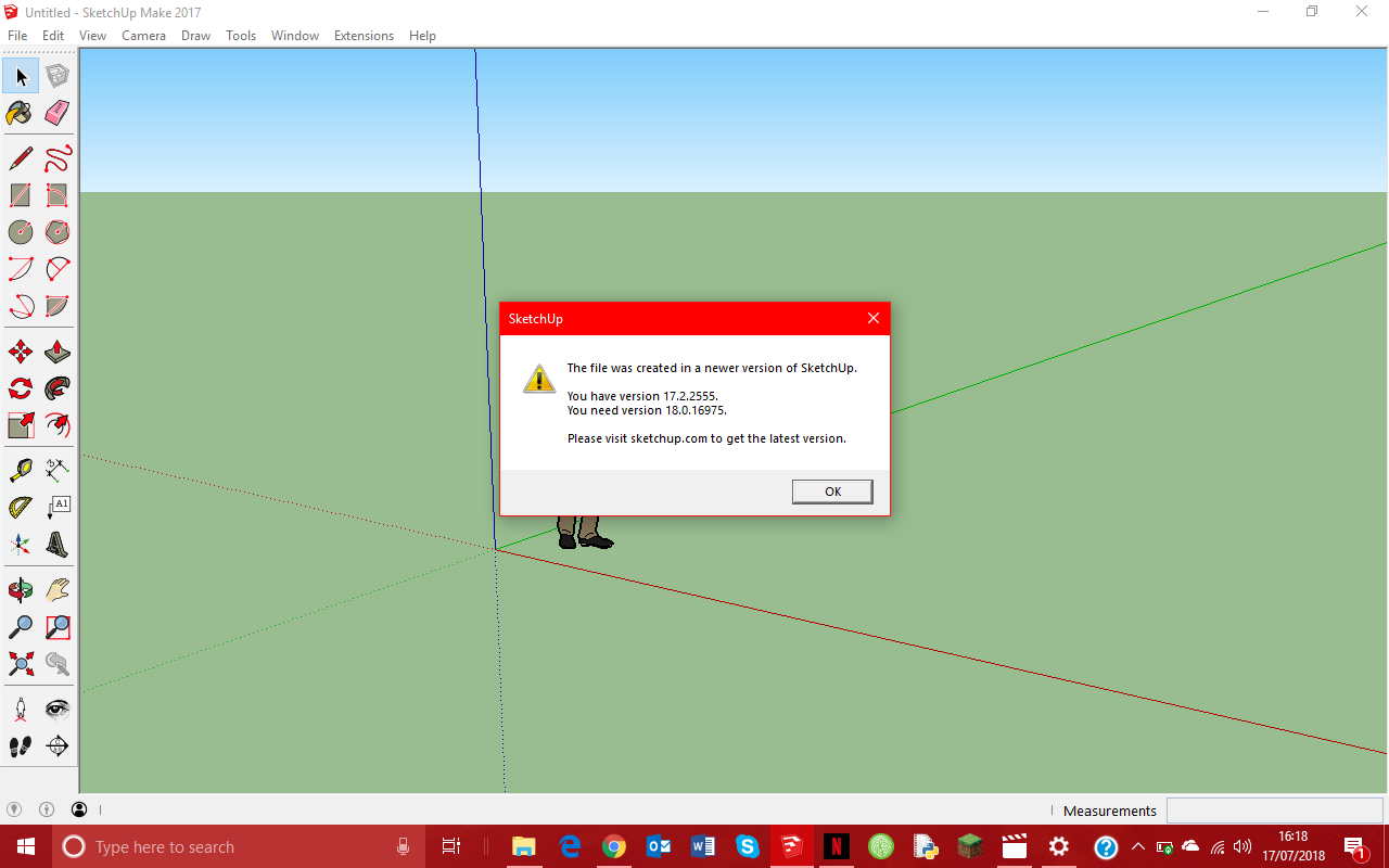

I accidentally updated my version of SketchUp to 2018. I don’t have a license and my trail has run out. I did the research and found I can only use the model I was working on in SketchUp free 2018 on the web. This is not really an option most of the time. I would like to know if there is any way of using the web version to allow me to use the 2017 SketchUp make with this model. It is a very important model for my school.
You can open the model in SketchUp free (web) and save it to desktop. This will convert the file in a skp 2017 file that you can then open in SketchUp Make 2017.
thanks will try
Or upload the files to the 3D Warehouse through your browser. It’ll convert them for you.
it worked thanks
