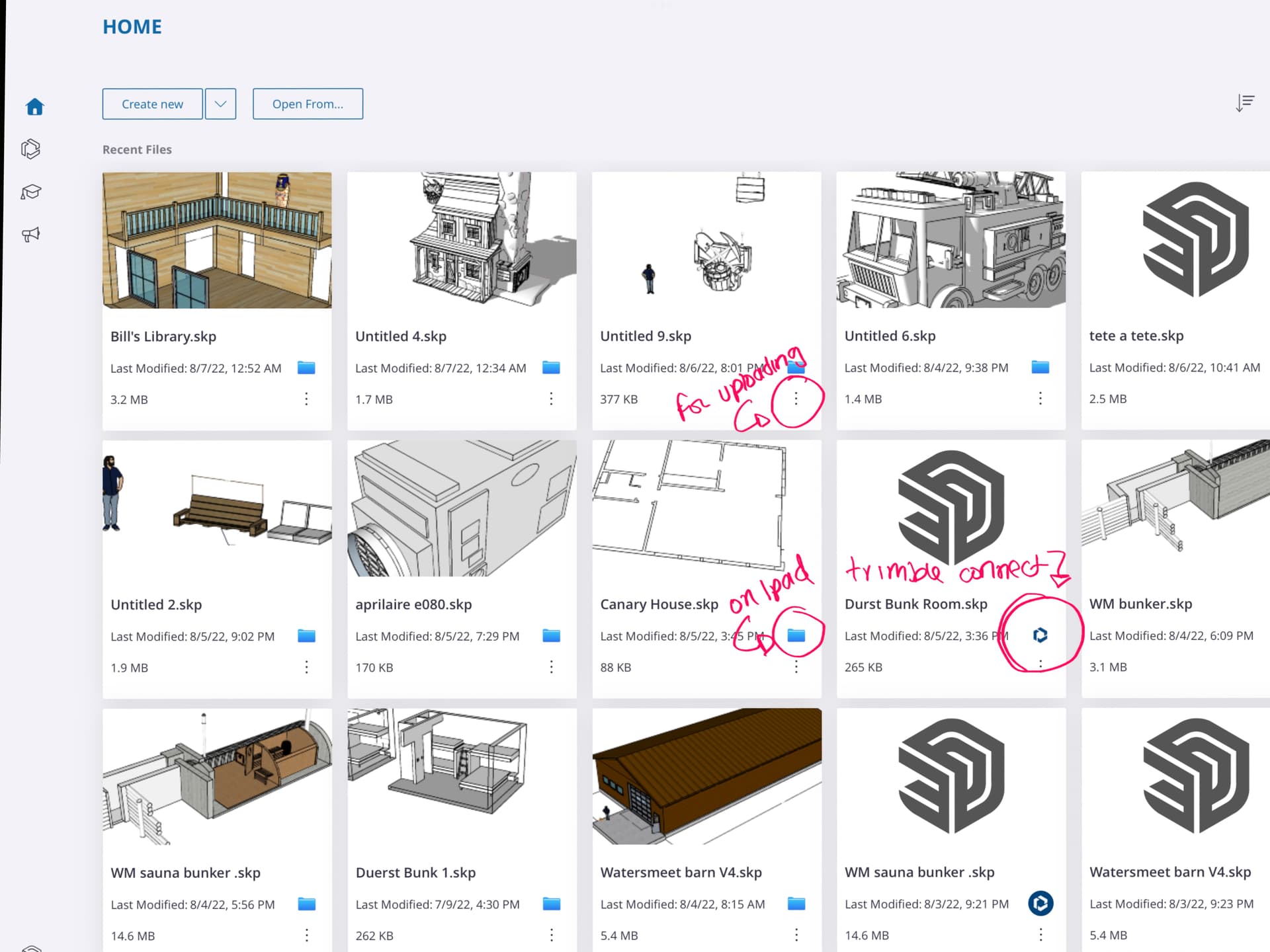

You can download from or upload to any of the clouds, but the easiest would probably be Trimble connect, right from the home page in the app.
The three dots menu has ā€œpublish to Trimbleā€ and then ā€œshareā€ which is everything else

Actually, even though the interface formats and capabilities are the similar, the models I create in Go all save directly to a folder in my iPad dedicated to SketchUp. They don’t go anywhere near a cloud until I demand that they do and then they take their sweet time about it.
At that point I can work on them while cloud based, but they take longer to save and certainly have a few more ā€˜we rescued this file you forget to save’ issues than the ones on the device.
The ones I download from trimble remain cloud-based until I make them ā€˜available offline’ or outright download a copy.
The difference between Go and Shop/web/free I think would be that the program has a legit home base where it will always start from.

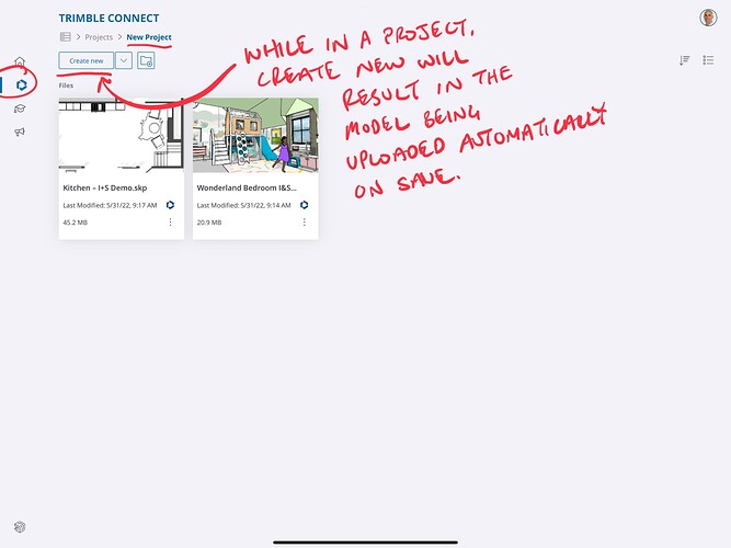

@Struller to add to what @Danimaupin has adeptly offered here, I’ll add that there are also a number of controls under the Trimble Connect tab on iPad.
From the Connect tab, you have the option to create new projects (in addition to the starter project that is created for you). Within a project you have the option to create folders and/or the option to create a new SketchUp model that when saved, will automatically be stored in Connect within the Project/Folder that you were in when you tapped the Create button.
Granted, this option requires a bit of foresight as we don’t yet offer the option to move files from one folder/project to another (although you can use the Trimble Connect web app to do all that).
