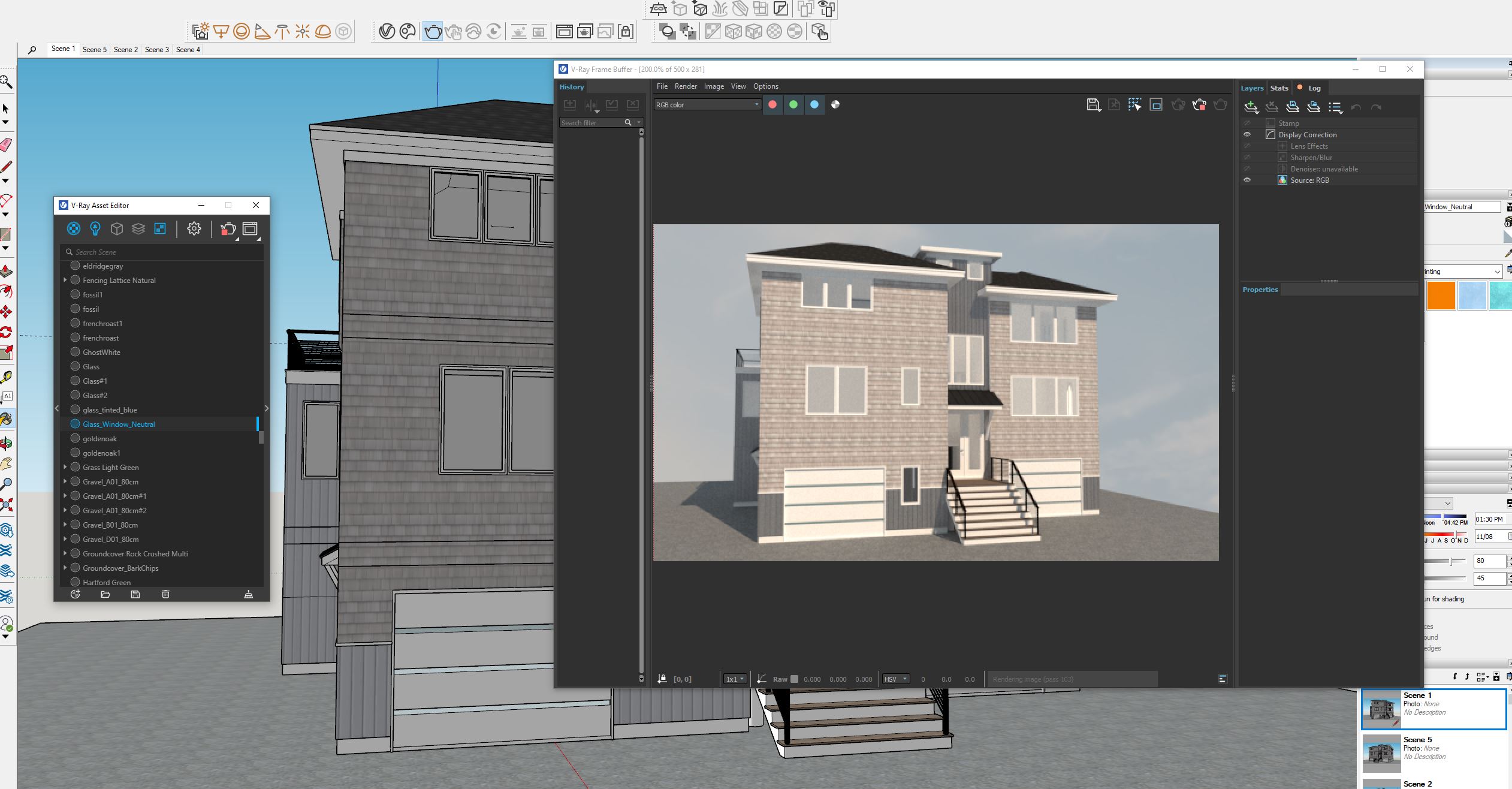

I am trying to render a house but the windows come up differently in the preview vs the actual render. Any reason why this could be? it’s been happening since i updated v-ray.

i attached screenshots (the best i could get with this issu

Post your model if you want more suggestions, but to me it seems to be mostly about reflections. The first image is viewed roughly from the same angle as the sun is coming from, so the reflections go elsewhere, and the second one is viewed from the angle where the rays from the lightest part of the sky are reflected into your eyes.
i’ll try the settings but everything seems fine. my issue is that the windows render differently between the buffer and actual render… the actual render washes the windows out.
color should be applied to inner walls? I’ve never heard of that but i’ll give it a try i guess it won’t hurt. i usually just leave the inner walls as default
no its the same at any angle the windows are washed out. sorry i posted different angles i didn’t mean any confusion. ignore the different angles of the house, it’s the same.
again my issue is the difference between the buffer and actual render.
everything seems fine when i preview the render, but when i actually go to render the windows are washed out.
default render settings? I don’t really mess with the settings too much… aside from size of the image. it’s all pretty much default.
it’s so weird i preview the render and i think it looks fine but when i actually go to do the real render the windows look like ■■■■ lol
In the settings panel there is quality settings and denoiser settings, i suggest you to set quality to high or high plus, denoiser should be vray and “at the end” set… My gpu is not good so, i disable interactive and progressive options off…
