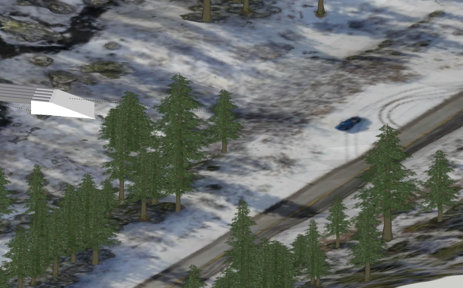

Hello everyone! I have been working on a model on my mac, but recently my model’s needs exceeded the memory I have on it. So, I have been borrowing a Lenovo ThinkPad from a friend, and this pc is generally way better than my Mac on all levels. The only issue I’ve run into is that all of my trees that I downloaded from the 3D warehouse now have an opaque background that they didn’t have on my Mac. I’m just wondering if you have ever experienced this before and if you know how to fix it? It’s not a big deal but it makes the trees look more “fake”. I will attach some pics next.
this is what it looked like on mac
and this is on the lenovo

I’m going to say this is due to the graphics card. This is a screenshot from your model on my PC with an nVidia graphics card. No white around the trees.
You could try switching to the Classic graphics engine in Window>Preferences>Graphics.

Ok it was on the classic and I just switched it to the new and now the problem is gone! Thank you!!!
