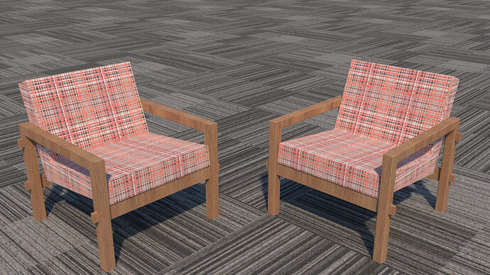

Here is a simple example. Two versions of the same chair, quick render in V-Ray, lousy texturing. One is 20 times heavier than the other. You might spot the difference, but does it really matter?
It is the general impact that matters. If you are doing an ultraphotorealistic render of a living room it might be possible to insert a single complex upholstered sofa but, for instance, in an office layout with many workplaces etc. every edge and face starts to count and the items shown ought to be as simple as possible. A single 3D tree in a rowhouse yard foreground might work but you cannot build a forest or park out of them.
