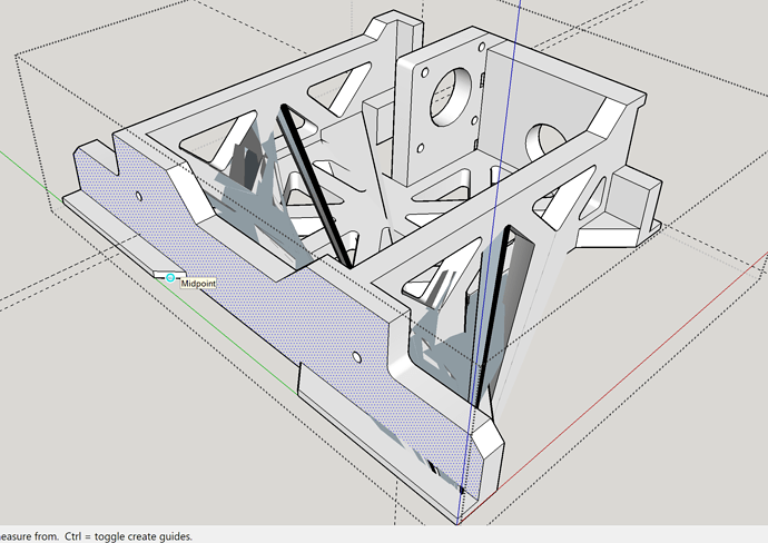

I hit Ctrl+S and this happened, it looks like large sections of the model got dragged to the front RT of the model:

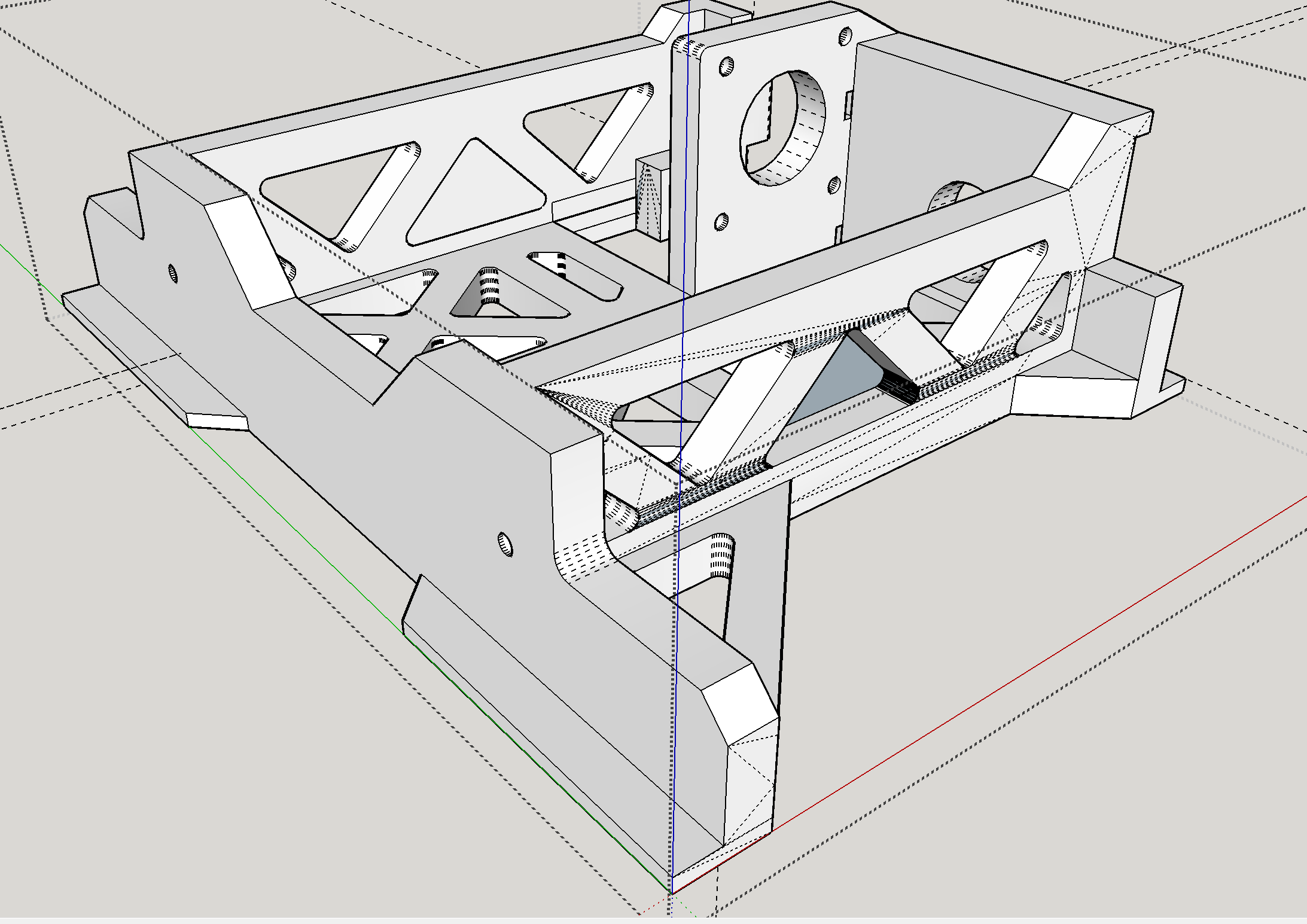

I hit back (Ctrl+Z) and it got worse (things just started disappearing), hit redo (Ctrl+Y) a few times and found that I could go back to the mess in the above picture, but even weirder, I had further to go forward (I didn’t do anything to it after saving, I checked in the edit pulldown and it had a “redo cut” what is a cut?) and I got something without the lines, the front face cut off the part and 2 of the side holes closed:
I’m afraid to go back or forward with it now, I’m hoping that it doesn’t crash in case going back or doing something to it as it sits can fix this (this is one of the files that I had Sketchup crash with when scaling).

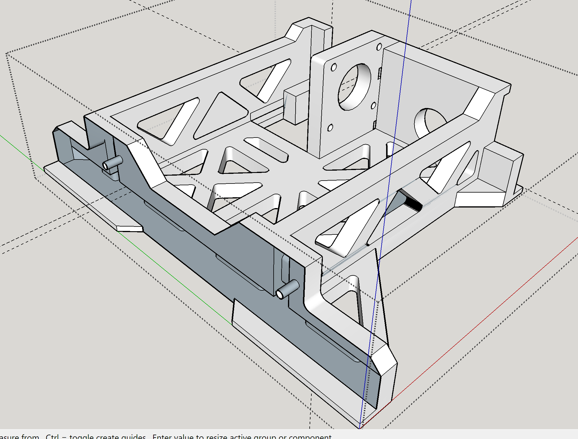

I opened the saved file in another instance and it looks different. It has the same to cutouts on the sides closed but it has all sorts of crazy hidden geometry showing on the RH side rail:

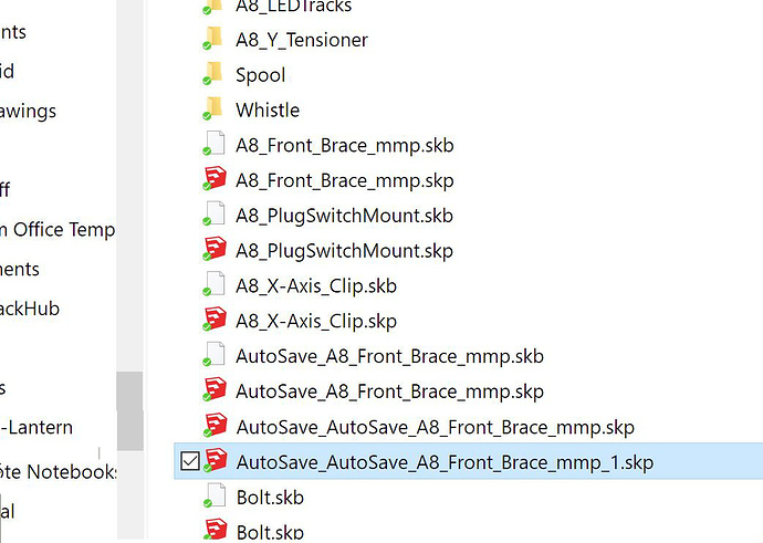

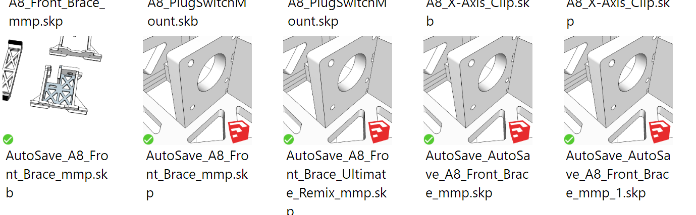

The other weird thing is that since this one has crashed a few times I have a bunch of different versions, the filename, autosave, autosave_autosave, autosave_autosave_…_1:
and they all appear to be very similar, all appear to be after the save and have the same icon but don’t have the same timestamp (they’re scattered over a 2hr timespan before I hit save and things went crazy):

Your first screen-shot image reminds me of the following. On numerous occasions (with SketchUp Pro 2014/15/16 at least) I have seen amazing explosions of geometry in the following scenario:
  1. save the model file
  2. the automatic validity check finds problems and makes changes to the model (introducing holes into what had been a solid component)
  3. I tell SketchUp NOT to attempt to fix the model, just leave results of the validity-check as-is
  4. execute the Undo function (to attempt undoing the changes caused by the validity-check operation)
The result of the Undo operation sometimes is creation of triangular faces (I’d guess dozens of them) that all stretch to a common point. This has happened to me often enough that I have learned never to use Undo after a validity-heck “gone bad.”
(To be clear: it’s the validity-check operation that creates little holes in the model, and it’s the undo of that validity-check operation that creates big triangular faces stretching to a common point. The little holes produced by validity-check are the results of merged or slightly relocated vertex points that were very close to each other. These days when a validity-check operation produces such results I manually fix them up.)

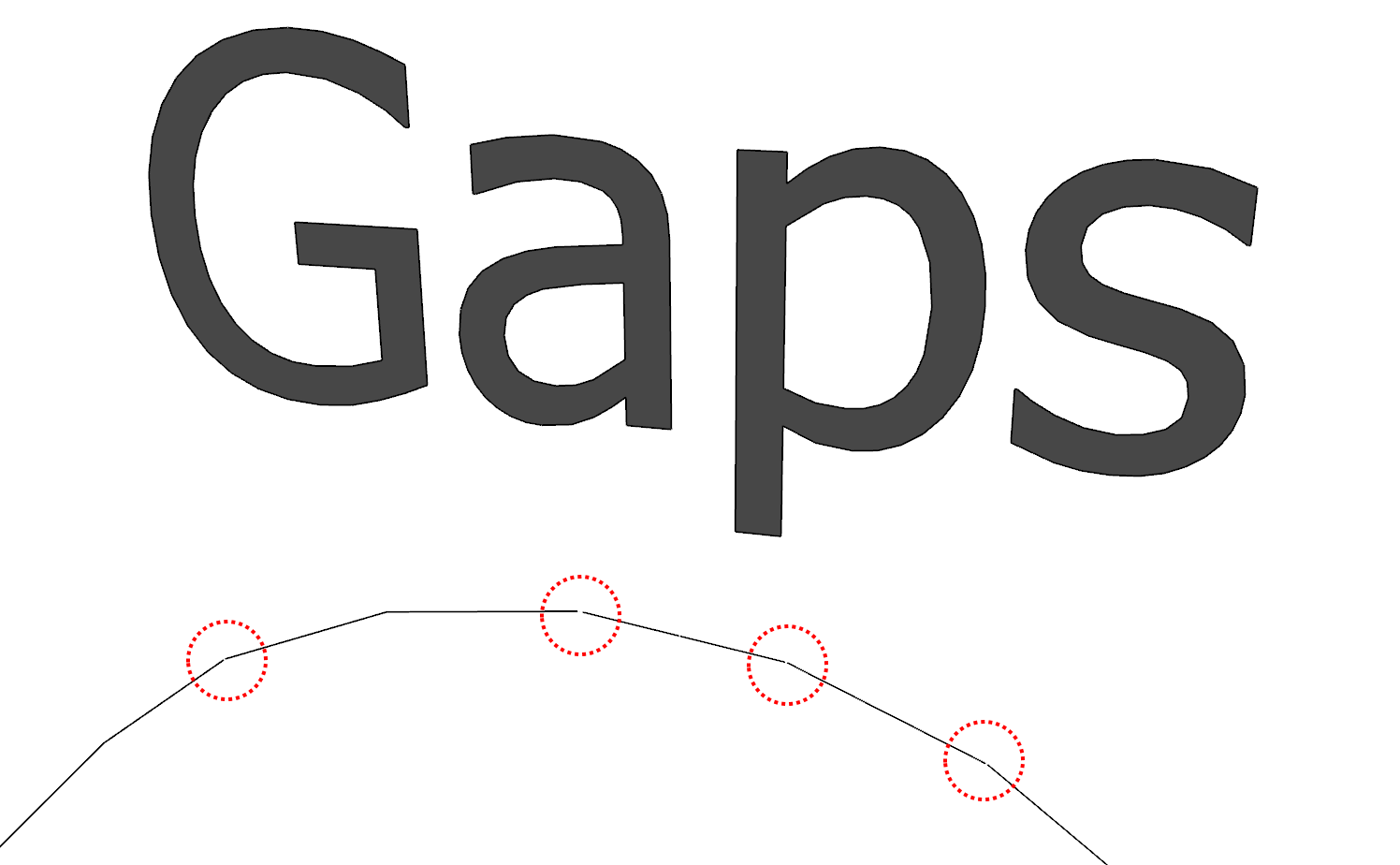

Notice the gaps in the side rail cutouts.
An autosave titled file is automatically generated by sketchup if the program fails to save or close correctly, i.e. Crashes. Sketchup is maintaining autosave files in the background all the time (if you have the option selected) but when you save your file while closing it and the operation is successful then sketchup erases the autosave. If you are seeing autosave titles files it is the result of a crash, that rescued file is the last saved version before the crash.
If you then open the new “autosave” titled file and subsiquently experience another crash then sketchup rescues that file with an " autosave autosave" file and if you open that one and crash again…
This is not that uncommon as it’s natural the try the offending operation a few times trying to figure out a way around the problem. I have to beat my head against any given wall at least seven time to learn anything. In this case the fewer the "autosave"s in the title the earlier the file was generated in the process loop, perhaps going back to the earlier files can help you find an un-corrupted version. Good luck.
