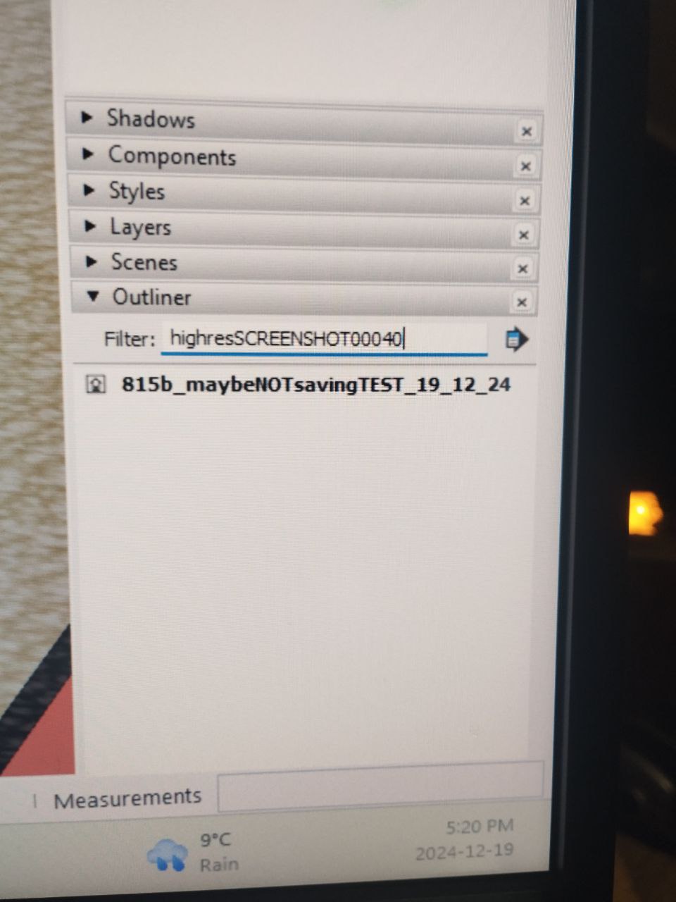

Can I look for that file name in the outliner to see if deleting it up there on the left did work or not?
to type that name into the outliner took like 30seconds to load the name after I typed it
but when I move around the model nothing seems slow
I also don’t know what that “filter” be used to find a file inside the outliner ?
AS per picture now inside the model that particular screen is deleted for sure.

Show us a screen shot of your scenes tray.
This sound like a graphics issue.
You are working on a very large model with a very high polygon count and a lot of textures…
Hi-res textures do also put a strain on your system as well as hi-poly count.
My guess: your computer and graphics card are maxing out as you are adding more geometry and more textures. Your budget is depleting fast due to your demands…
