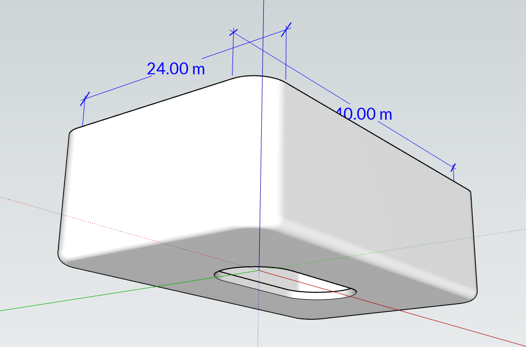

I made a quick example. I don’t know if the hole in the bottom is the right size but the box is modeled in meters.
I downloaded the .stl file and opened it in the slicer. As you can see the box is 40mm by 24mm by 12mm tall.
Also, instead of using 6 sides for the arcs I used 48 to get smoother curves.
