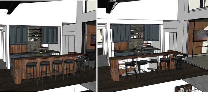

What happened to my file?
I was downloading from the 3d warehouse, after download the screen just showed blank screen with 2 guides only. Sketchup went non responsive and when file was reopened it looked like the image on the right. The image on the left is my backup file, so I’m not completely screwed, will just require relinking file in layout. Question #1: Can you tell what happened? #2 Is there a quick way to update all the file links in layout without going through all 40 pages?

My guess is that whatever you downloaded from the Warehouse has “astronomical” dimensions: items far from the origin or very large things, or geolocation.

Part of the issue was a couple of components that wound up at a huge distance from the rest of the model. All sorted now.
Thank you Anssi, you were right! Dave helped me fix my model, and got me back on my way. Appreciate your input
