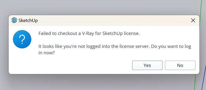

So… persevered with 2024… Now this keeps happening when I try to start VRay or Chaos Cosmos…
What’s going on now?
How is this fixed?

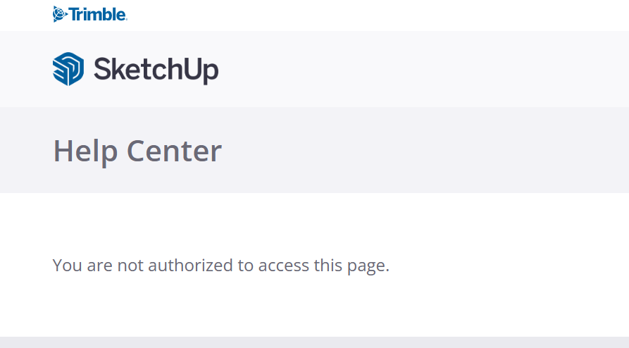

Hi…
Thanks for the help… However. When I use the link, I get this:

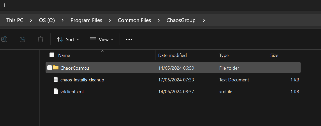

Aaaand, I don’t have a folder called SSL…

It should be in
AppData\Roaming\Chaos
