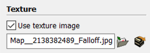

If you can’t update Enscape, one thing you can do is go to each material, right-click, export material (as JPEG or PNG, whichever you like), then in the Edit tab for that material you can use the folder looking icon to browse for a material, and then point to the file you just exported.
