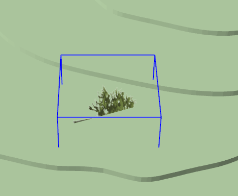

So this is what happens when I import the tree in

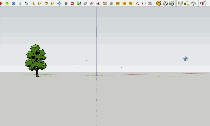

Some trees have locations but no points to place them on
Looks like maybe the model axes have been rotated away from their default orientation. Right click on one of the axis lines and click on Reset. Does that fix the tree import issue?

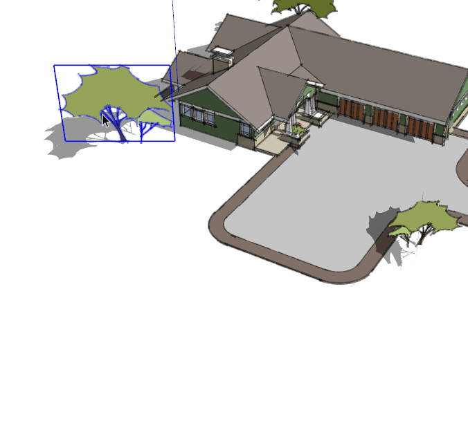

Here’s the extension in action.

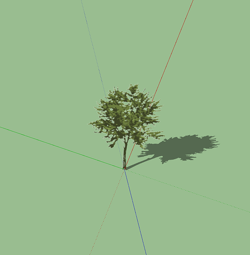

Ok, so I opened the file that had tree and this is what it looks like for some reason
like i can reset but why is it like this
fixed it now all i need to do is plant a metric ton of them
I don’t know why it is like that. It would likely have been something the author did. The solid blue axis should be pointing up through the top of the tree. The red and green you’ll want horizontally and at the origin at the bottom of the trunk.
