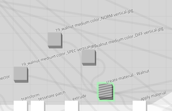

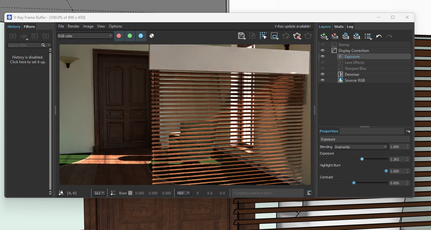

Greetings Keith. I have literally only just discovered LC and, sad to say, up until yesterday I had no idea that visual scripting (is that the right term?) was a thing. Now I’m keen to learn more but there doesn’t seem to be much information out there.
The forums here provide some great information and “tutorials” so I’ll work my way through those. I started working with a venetian blind LC from Sketchup yesterday to try and understand how it’s all set up. My very first question is to do with materials.
I see from above that materials can be dropped into the graph so I’ll experiment with that. My question is - does V-Ray read this information directly from the component? The blind renders well as it comes but I want to change the blind slat material to timber. I can’t find either of the existing two materials shown in the graph in my V-Ray list of materials so I’m wondering exactly how it’s coming up with the right look.
With thanks from a complete newbie.
Hi Chimurengagirl,
Glad to hear you are exploring Live Components!
Regarding how the Material from a Live Component gets into V-Ray? As you suggested, it does read the material directly from the component (just like any other material in SketchUp). The create material node in a Live Component graph creates a PBR (physical based rendering) material and it should translate into V-Ray with reflections/roughness appropriately. Adjusting the roughness/reflectivity of the create material node should translate all the way through to V-Ray.
If you want one of us to have a closer look at your graph & Live Component, feel free to share a link to the saved graph (save in Creator and then copy the URL here).
Thanks,
KT
Hi Keith and thanks very much for your quick response.
I had a go at changing the material of the venetian blind slats on a copy of the original component (obtained from the Warehouse) and appear to have succeeded! I don’t fully understand the rest of the graph by any means and I’ve chose a particularly complicated component in my usual manner of making life difficult for myself, but it’s a start. I’ll experiment with simpler things.
Thank you!
