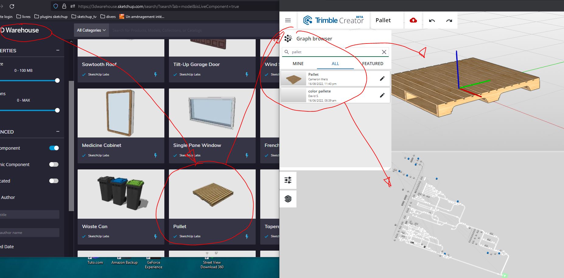

How do you open one of the live components that you’ve downloaded from the 3D warehouse in Creator so you can see how the graph is built?
Hi Foxtail,
Not all Live Components will show up when you search for them… (we have hidden some that we want to re-build / re-layout). Search for the LC in the graph search, and make sure you select “all”:
We are looking to add a feature to make opening LCs from SketchUp easier soon.
@Foxtail
Hi Foxtail
there is not a lot of documentation I have a little search everywhere and for the live components which are on 3dwarehouse, you look at the name of the component and you do a search in the graph (look at my screenshot) and if it exists you will find it and you will have the corresponding graph

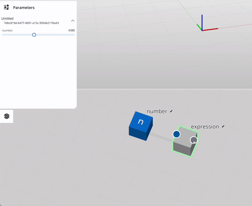

Is there a way to display a result value in the Parameters ?
Yeah, you can drive a parameter node input with a connected value. Simply connect to the input of a number/string/vector parameter node.
This isn’t always a good thing. In theory, parameters should primarily be used as input for the graph, not output. It does provide a quick way to keep track of a value as it is computed though.
Yes, logical, but since there is no console (yet?) or status line or any value tracking…
On a side note, I find that the error display in red is just great.

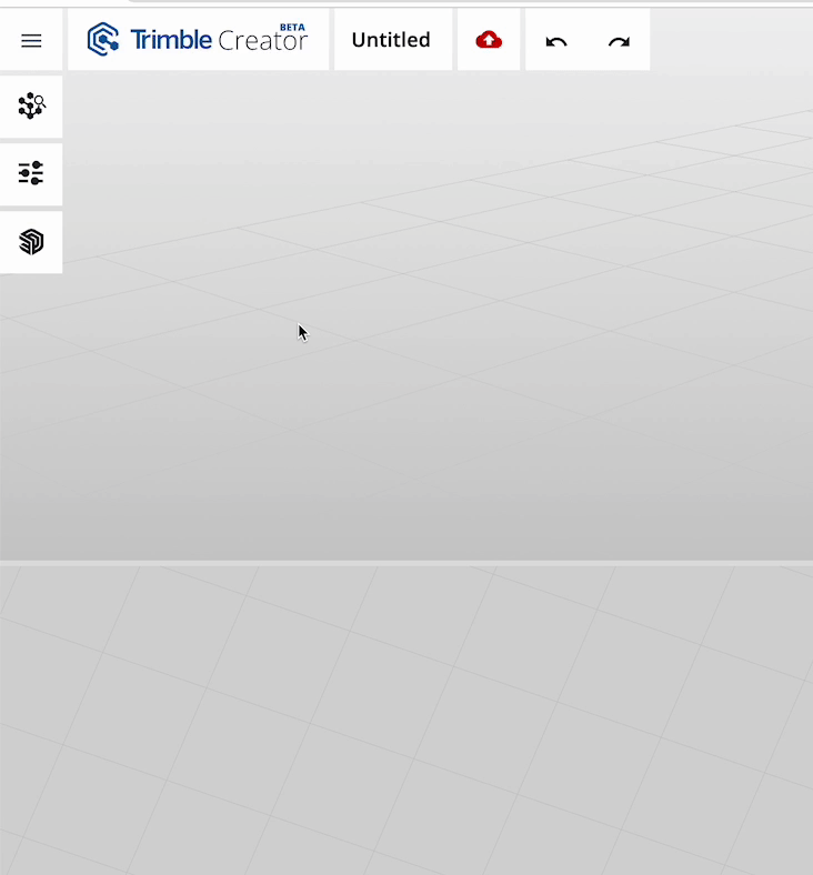

Have you found output inspection?
Be careful to have the node output selected (otherwise you might inspect “stale” values):

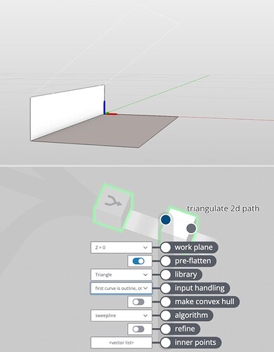

Starting to get Creator just a tiny bit - and starting to realise its incredible potential. But I’ve come unstuck on creating a face on an angled rectangle.
As per the attached screenshot and link - ‘triangulate 2d path’ works for the rectangle on the left - but it won’t work for the angled rectangle above it, as it isn’t in a standard work plane. The nearest I can get is a corresponding rectangle on the floor. Is there another node I should be using for this?
Here’s the graph: Trimble Creator
Thanks for your help.
S
