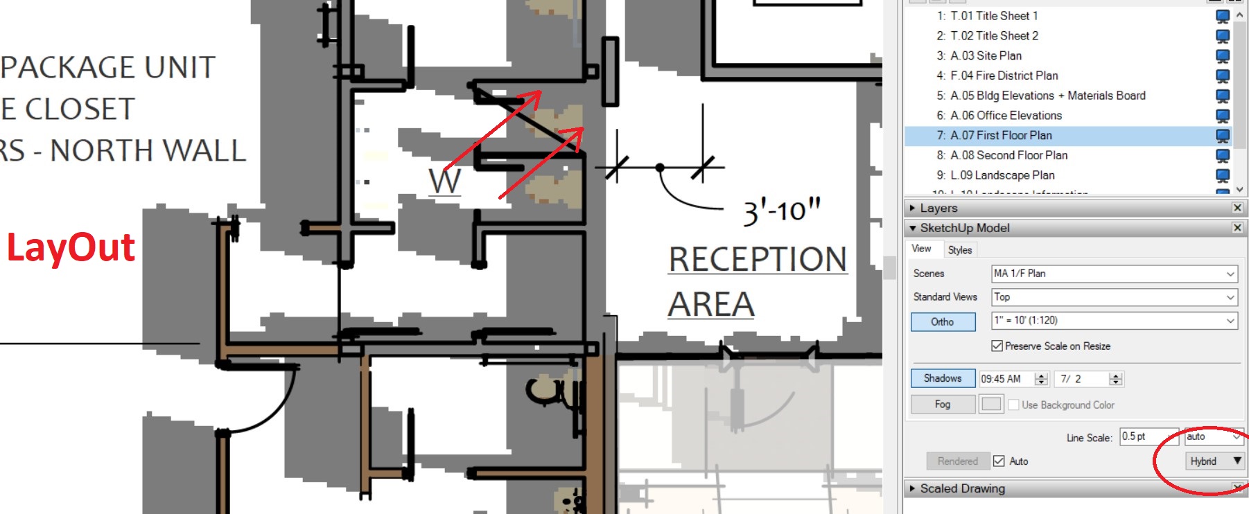

Just wanted to let you know I have had the same experiences, utilized same solutions, as noted above, however, resulting in same results as noted in post below (diagonal artifacts disappear in LayOut, but remain in *.pdf). Also, this is a new issue for me as a result of 19.2 update.
Lastly, in my observations with a diagonal artifact in LayOut, I noticed that there are also missing vector lines adjacent to the diagonal (as noted with red arrows). See Below:
As compares with after changing to Vector mode and back to Hybrid.
Good luck in your resolution.

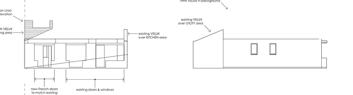

PDF output…

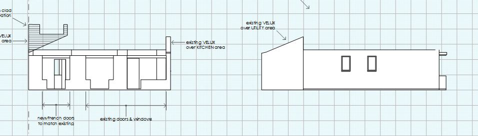

LO…

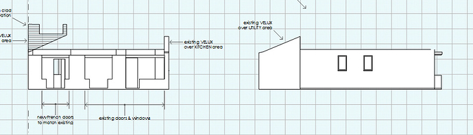

I’ve done some investigating and for the model that I mention above it seems that one particular simple window component that I’ve copied and pasted from other models seems to be the cause of the odd artefact line (I’ll have to check if these other models have been the ones also causing this for me in LO).
It’s strange because these two window components only seem to cause the artefact line when I have the wall layer turned on which has the windows in. If I display only the suspect window (and nothing else) in the LO viewport and export to PDF the line is not there. If I display everything except the suspect windows then the artefact line is not present in the PDF. Of course there could be something else going on…?
SketchUp developers - would you like me to email you the model?
Suspect windows and walls turned on in SU model…
(the side elevation on the right shows the suspect windows)

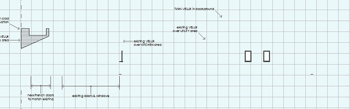

PDF output…
Windows only turned on…
PDF output…

PDF output…
Update…
I purged the wall group only and this resulted in no artefact line in the exported PDF.
I then undid the purge and exported to PDF again and the artefact line came back.
I then went through the wall group and for each apparent miscellaneous line element that wasn’t relevant geometry for the creating the 3D volume that is the wall, I deleted the individual line element, updated LO and exported to PDF.
Doing this it seems that just one miscellaneous line not required for the 3D geometry was causing the artefact line. Other non required lines in the group did not cause the artefact line.

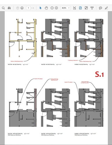

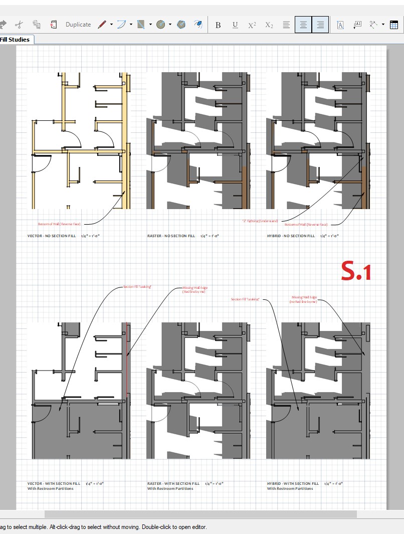

I have done a little more investigation of the Artifact diagonal line issue in *.pdf.
I have found a connection in my model/drawings of the artifact diagonal lines and section fill, and artifact diagonal lines and a separate (restroom partitions) group.
Also, note diagonals in Vector and Hybrid viewports when printed to *.pdf.
Compare S.1 top and bottom conditions.
Diagonal artifacts (and ‘leakage’ of section fill and missing wall lines in Vector and Hybrid views)
Walls group is a tested (Inspector2) ‘Solid’.
[First upload LO, Second upload PDF]

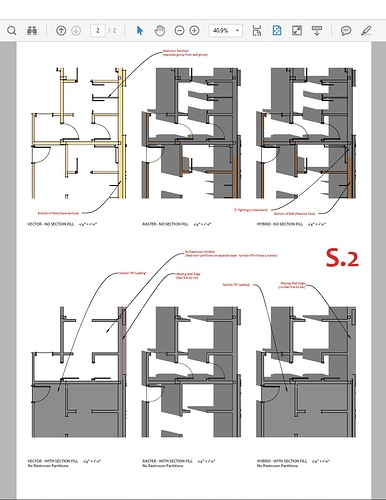

I then tested why diagonals occurred where they do, and turned off Layer = Restroom Partitions.
Compare bottom of S.1 and S.2, no diagonal artifacts. Still leakage and missing wall lines.
[LO Uploads]
[PDF Uploads]
If you would like SU model and LO drawing files let me know.
