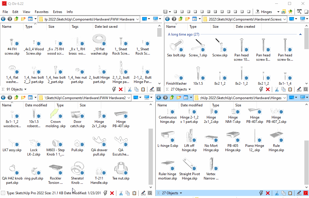

Once you get your folders set up you can move the contents around in File Explorer or other file manager. I use an app called Q-Dir when I need to do file sorting.
