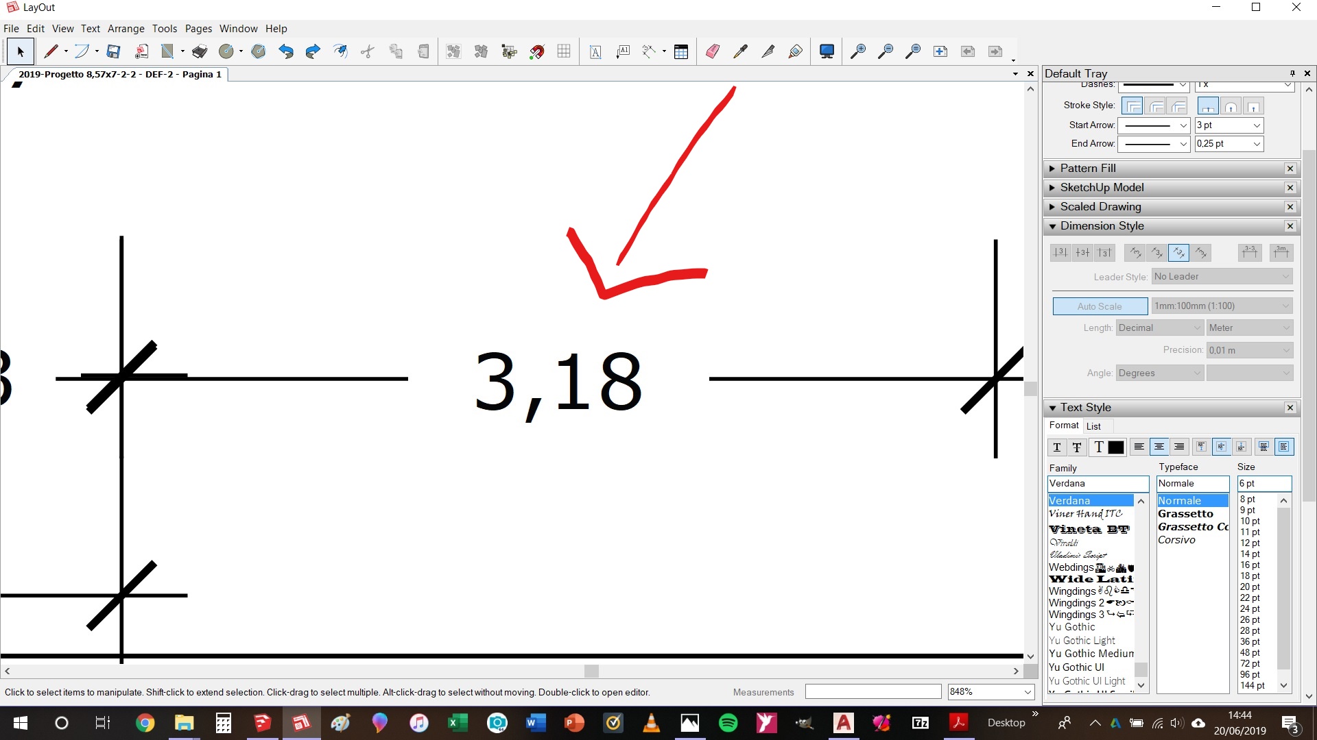

This is the problem: when dimension are placed orizontally visualization if fine. When placed vertically there are some missing partes.Uploading: 2_LI.jpg…

OK. Thank you for sharing that file. It made it possible to see what is going on. It appears there’s a bug related to the size of the paper. If you move the content toward the center of the sheet, the problem goes away.
Screenshot%20-%206_21_2019%20%2C%207_13_14%20AM
If you must work on paper that size, the only current solution I have for you is to turn the the dimensions so the text is horizontal. I’ll file a bug report on it.
Great Dave! At list I’ve got what’s the problem. I will follow your advice.
