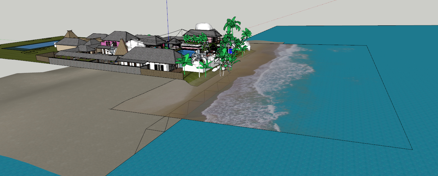

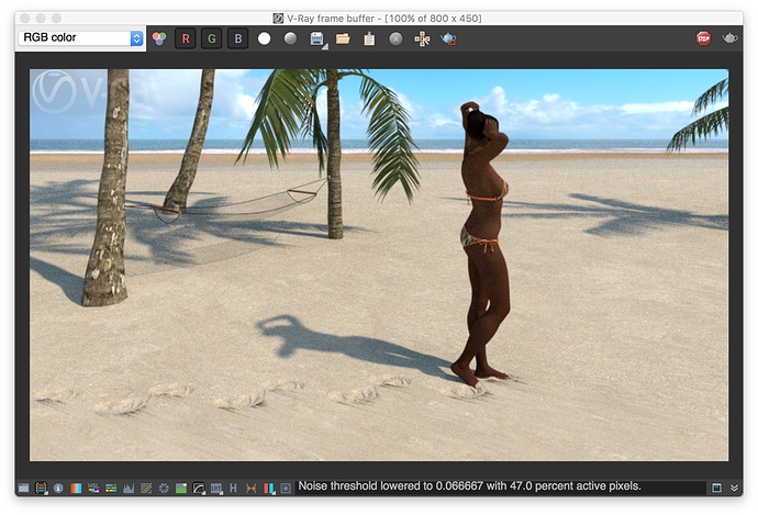

I just subdivided those areas more with artisan and sculpted indents around loungers, rocks, feet and trees. You can see my sea plane only goes out 20,000’… a bit big and which incurs some clipping issues.

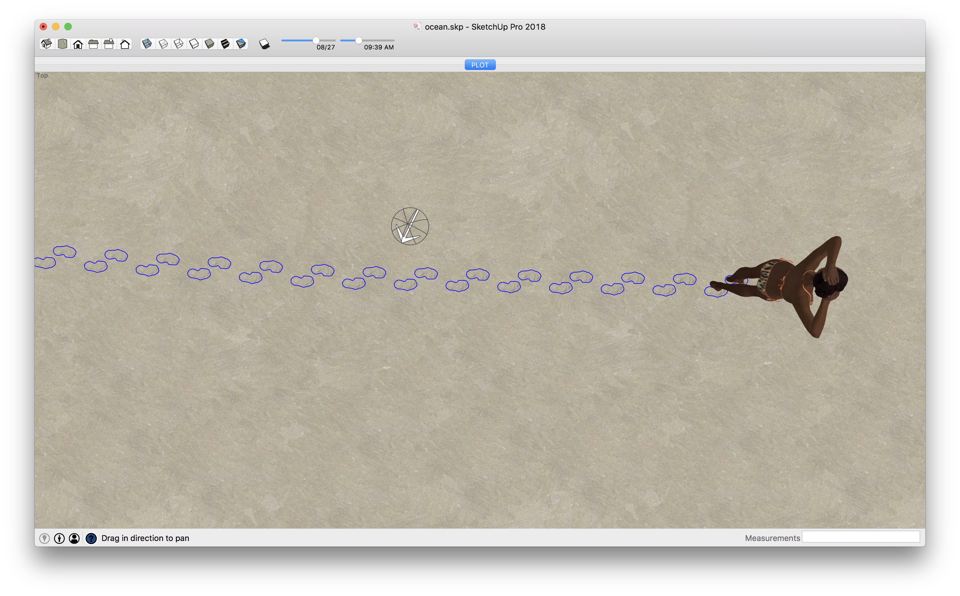

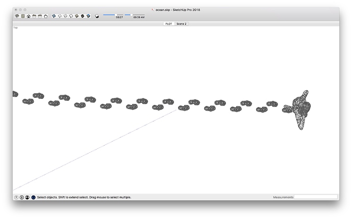

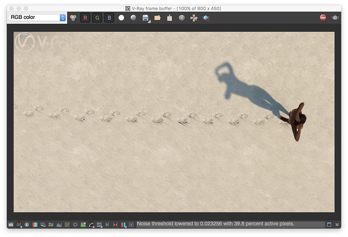

Ok. So tried to do footprints in the sand and result may not have warranted time involved. Used Bitmap2Mesh to make 3D impression. Then ‘Skattered’ footprint components along path. Then intersected with sand surface and removed flat part of sand inside of footprint.

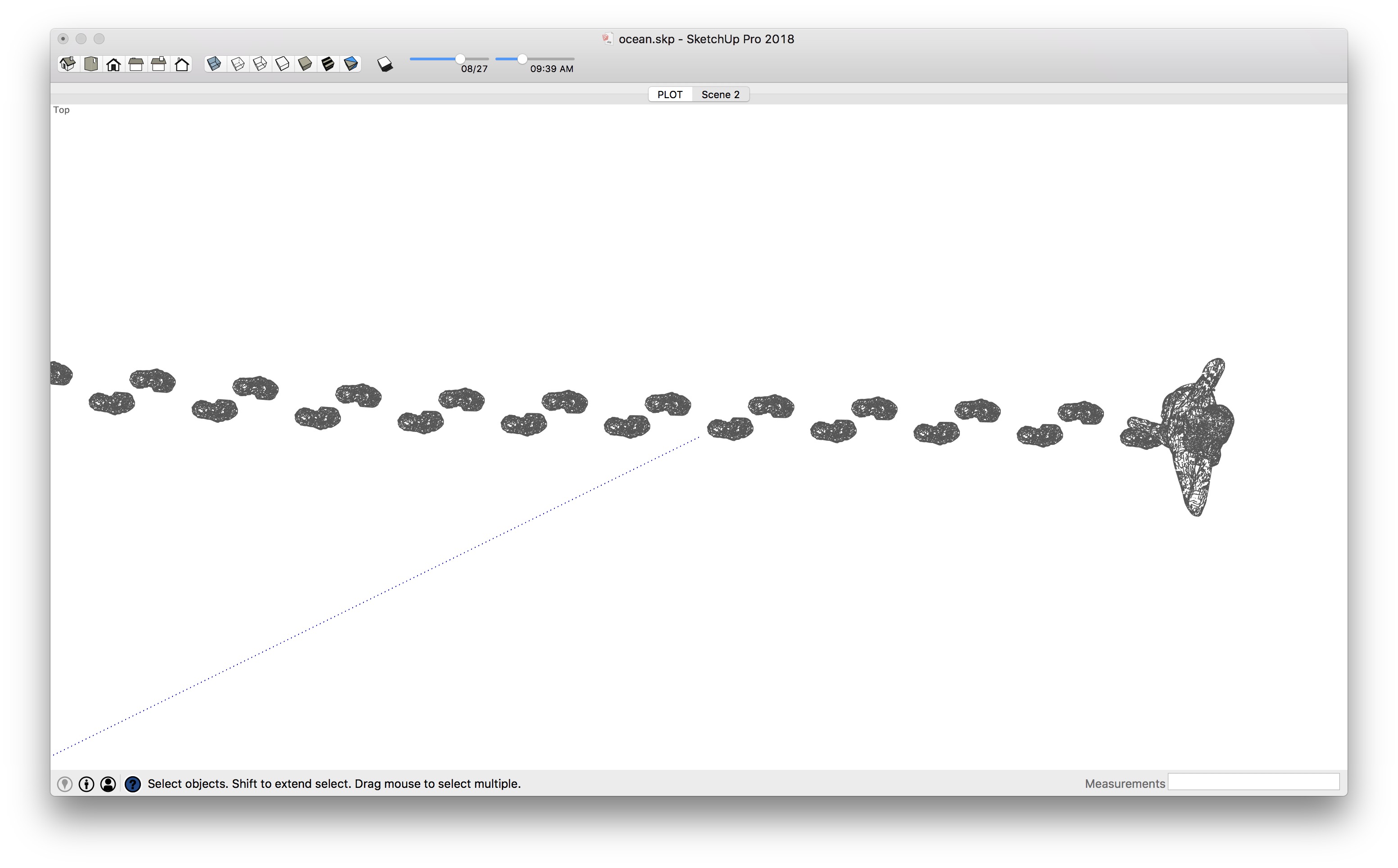

As you can see VRAY was doing something strange with the sand texture around the footprints. hmmm…
Maybe the sand mesh in the footprint areas needs to be finer as it looks like SU is making “bad” geometry? I dont think its a Vray issue?
It’s a nice idea, but as you say, the time spent might be counterproductive. I think making some dents with the artisan brush might be easier and the randomness of it makes it a little more organic given that sand will react differently in different places?
Yeah, not a Vray issue.
It’s how SU deals with geometry with non-regular holes/ deformation. The surface is triangulated when passes to Renderer. You have to ‘isolate’ the hole boundary geometry.
You can see the effect if you export a model in any 3D format from SU it goes through a similar triangulation process.

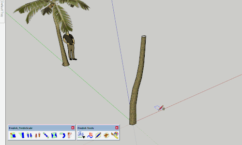

Or if you want to create your palm tree with the shape you need:
pal-03

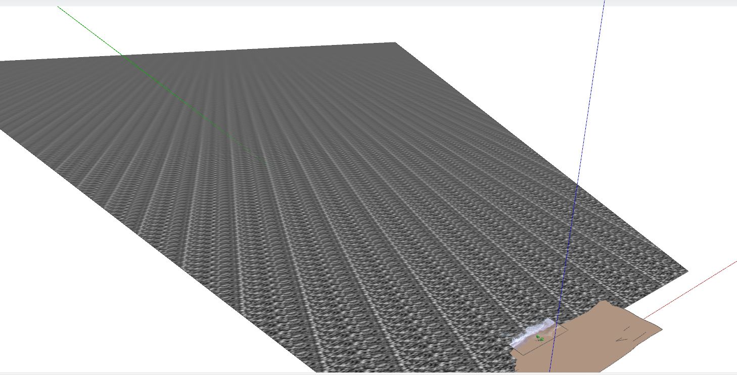

I have to place more than 1.000 trees… If I had them all in curves my PC would explode.

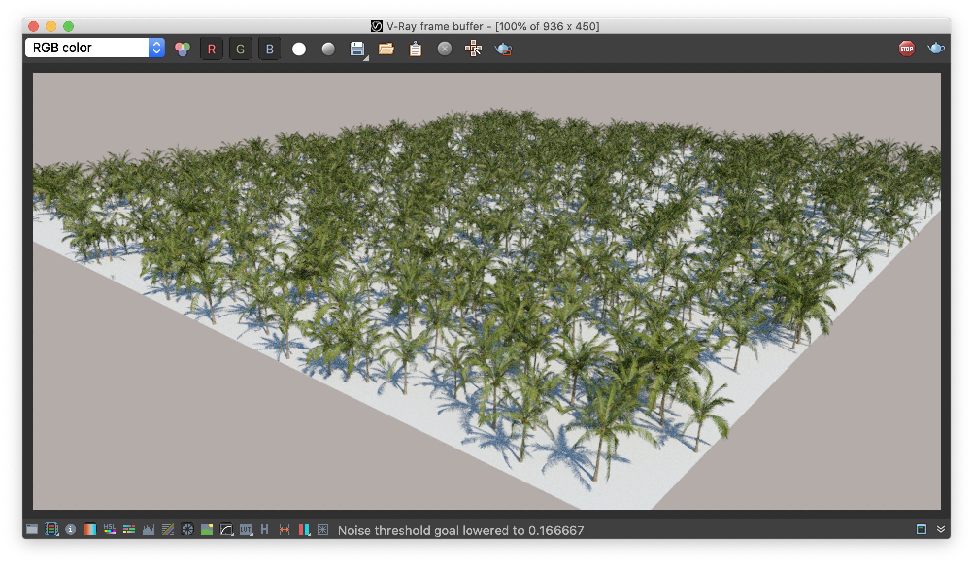

No Problem. To your point about 1,000 trees. Here is 1068 trees. Files size 719kb (yes, kb). With ±500,000 polygons (manageable). Edit: if you found a tree elsewhere or made one like @mihai.s suggested, just be sure to use V-Ray Proxies to keep your model running smoothly.
Hey Eric, thanks for the reply!
I’m using the trees you suggested and they’re magnificent!
I also discovered Skatter for populating the land with trees, which is doing its job.
