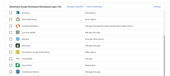

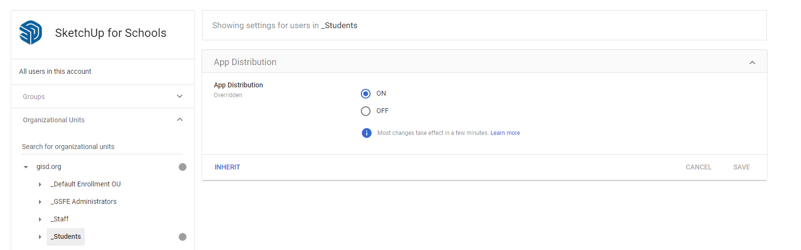

The âAre you in the right placeâ error message indicates that the app has not been allowed by the administrator of your domain. Unfortunately this is not something that we can do on behalf of you and your students, and will need to be done by you schoolâs IT administrator or the person the holds administrative privileges for your educational accounts. I saw in a previous message that they had tried to do so, but itâs possible that they do not hold what Google refers to as âSuper Adminâ privileges. Would you be able to provide a screenshot of the permissions screen that they see when deploying the app?

As for you @GISDTech, I have done everything I can to verify things on my end and have passed along everything to our support team and mentioned your issue to @Tori_SU. In the meantime, can you try and figure out who the super admin is and have them deploy the app? Just a regular admin wonât cut it with the way Google has things structured and there isnât really anything we can do on our end to change that.
