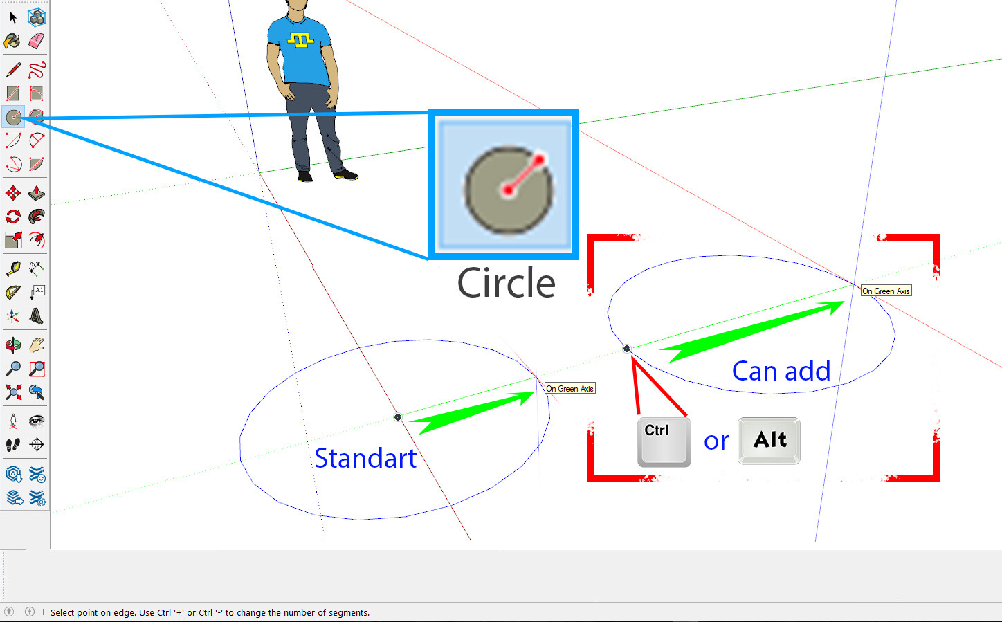

It would be possible to add a “circle” when pressing Ctrl or Alt so that the plotting axis changes, I know there is a plugin like this, but still
You mean to draw a circle by its diagonal (diameter)?
BTW. It would be better if you open a new topic as feature request, because this topic is about something totally different …
In diameter, I just saw that the discussions were in SU 2021.1 and there they added changes to the square, so I decided to write
