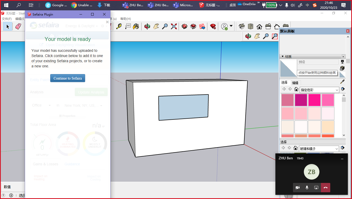

I’m not able to upload my model to sefaira web app from sketchup. When I clieck the button Upload to Sefaira in sketchup, it says
“You model is ready
You model has successfully uploaded to Sefaira. Click continue below to add it to one of your existing Sefaira projects, or to create a new one.”
However, nothing happens!!! No web browser pop out. Then I open my chrome web browser and logged in to my sefaira account. Nothing in there!!! No project has uploaded at all!!!
I changed another computer and same!!! I’ve been stucking at uploading for weeks and I’m going to be crazy!!!

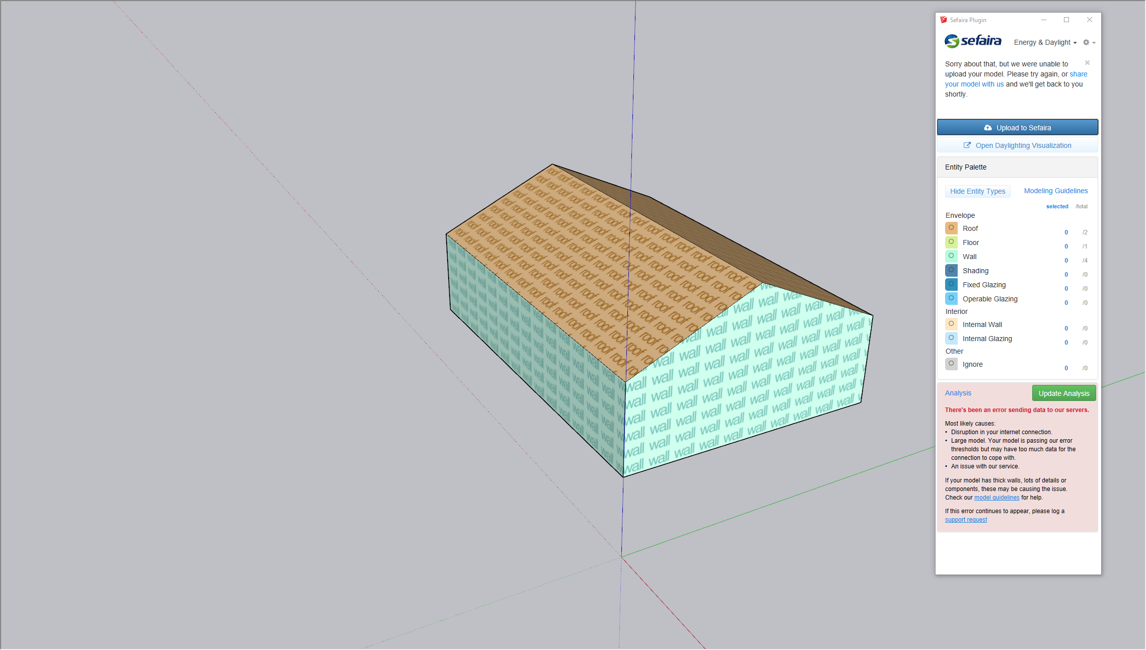

Today I try again and got the screenshot like this.
It seems that Sefaira server got some problem?
I understand that the plugin got something wrong with the connection to the default web browser. It couldn’t call and link to the browser in my PC. How could I sort it out?

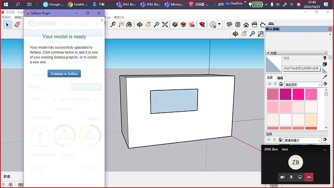

  1. Win10
  2. 2020pro
  3. I cannot upload the model to the web tool
    when I click on continue to sefaira button in the picture, nothing happens
