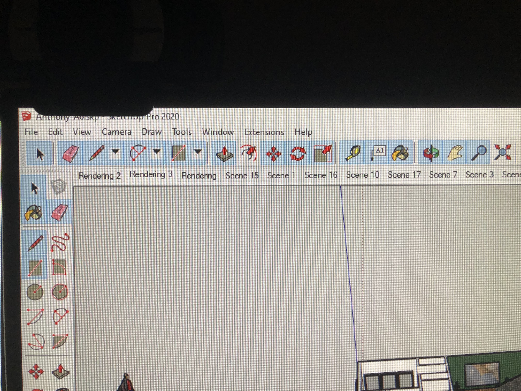

Tools stay activated when trying to select a different tool. Then they stay activated as well
Student here new to sketch up. I don’t know what’s going on… Shortcuts stopped working, and all my tools keep staying activated when I’m trying to select a different tool (See photos), and I’ll keep selecting different tools to try and reset it, but the pool of activated tools just gets bigger. Am I doing something wrong or is this a bug?
That is very odd. My guess is it is one of the strange things that happen when windows hasn’t installed it correctly.

Thank you for your help, I’ve done exactly that so hopefully that does fix any bugs it had. I did fail to mention that Podium Extension is installed… but hopefully that wasn’t the cause of it.
