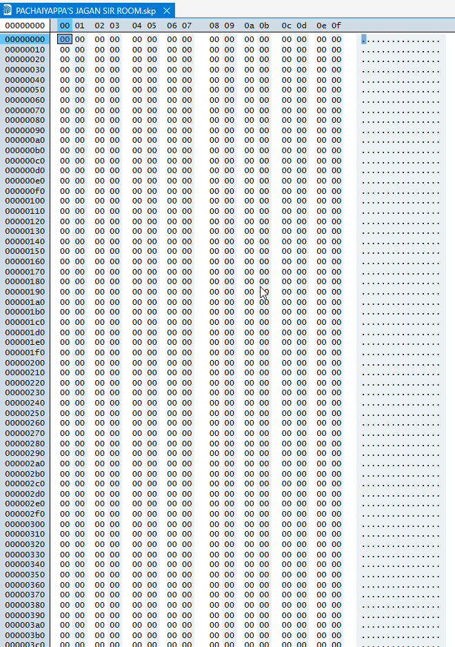

The file contains nothing but zeroes.

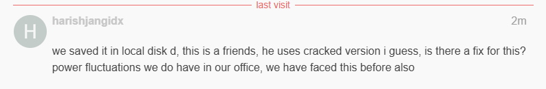

we saved it in local disk d, this is a friends, he uses cracked version i guess, is there a fix for this?
power fluctuations we do have in our office, we have faced this before also
