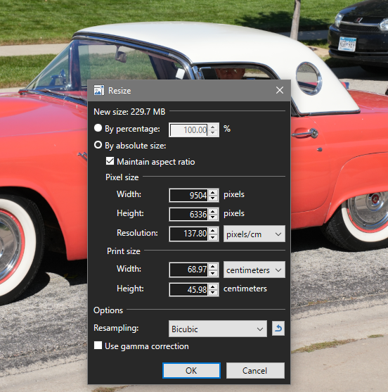

Good deal. FWIW, I had made an example to show you but got called away. I’ll share it anyway. Images get inserted at 96 pixels/inch or 37.8 pixels/cm. This used to be called out in the online Help files however I can’t find it now. If you insert a large, high res image into LayOut the image will be huge and you’ll need to resize it and you’ll bloat the LayOut because it stores a copy of the image file. Here’s an example. This is an image from my camera. (I’m showing a screenshot of it in my image editor.)
As it comes out of the camera the file is nearly 230 MB.

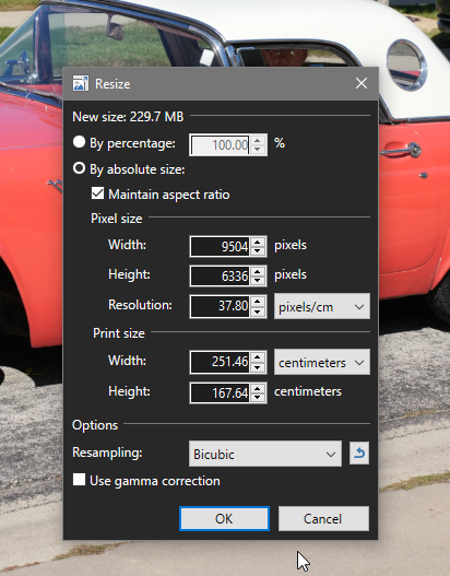

At 96 pixels/inch (37.8 pixels/cm) the image would be over two and a half meters wide.
If you wanted the image to be only 10 cm wide on the page you could reduce the image to 378 pixels wide. That would reduce the image file size to about 370 Kb.
Inserting the resized image would allow it to insert into LayOut at the desired size. It would be predictable and you’d only need to position it on the page. And you could insert more than 600 images at this size for the “cost” of one of the full size image. Basically inserting huge images into LayOut is kind of like trying to pour an entire bottle of whisky into a shot glass. You only get a shot of whisky to drink. The rest is on your shoes and you’re out the full price of the bottle.
