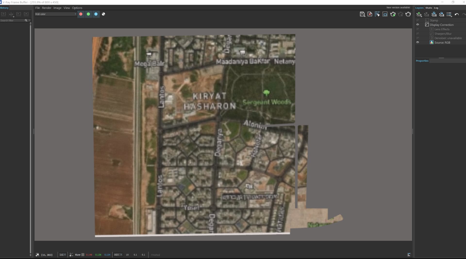

I have a problem, no idea how to fix it.
I have only one face in the model, with material (from geo location), and grouped.
Everything is fine in Sketchup,
BUT… unfortunately when rendering (vray 5) - texture placement is moving and render is wrong.
Face is front side,
material is on the face, not the group.
I attach 2 PNG display the situation, and the sketchup file itself.
sketchup file.skp (655.2 KB)
I will appreciate your help.
Thanks
rachel

I have tried, yet not working :slightly_frowning_face: :slightly_frowning_face:
I see that in your computer it works.
I have send to a friend who has Vray,
and it works in his computer too.
But in mine - NO !!!
More to say, at first it worked and everything was OK, and suddenly yesterday it stopped. It is only part of a very big project, and now I am stuck :weary:

But now I try again, and again it is not working !!!
I don’t know what to do :weary: :weary: :weary:
It once suddenly worked, and again NOT
OK, I found the solution.
The diffuse map in Vray was different from the one in Sketchup (I don’t know how and why…).
So I reloaded the map to be the same one which is in Sketchup, and it WORKS :innocent: :innocent:
