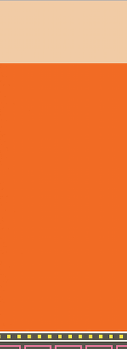

This is a screenshot taken of a segment of one of the textures I’m using as it appears within Photoshop, Affinity, and Preview.

That’s the problem. Open the .jpg I posted by itself in Preview, Paint, whatever will open a standalone .jpg. It should be bright orange like in the first screenshot I posted. But when I posted the file itself, the forum here is also showing it with a reduced brightness and contrast, and when imported into SketchUp, the B&C go way down.
The original file should be showing bright, vibrant colors. When imported into SketchUp it gets dark and muddy.
I’m not seeing the bright orange color in the image you uploaded before Aaron’s screenshot. the Banner segment jpg file you upload is not bright like in your earlier posts.
When you download “Banner Segment.jpg” and open it on your computer in something other than SketchUp - something like Preview or Paint or even Photoshop - it it still showing up as muddy and brown, or does it show up bright orange like in “Original Color.png”?

Wow. That’s bizarre as hell. This is how it looks in Preview, right next to the SketchUp file it with applied.
Well, You’re seeing it as brown in SketchUp. Aaron and I see the same thing. Only Preview seems to be showing it as orange. I would be suspicious of Preview instead of SketchUp.
I get the same bright orange in Safari, Photoshop CC, Affinity Photo, and in Outlook and Mail when sent as an email attachment. Though, interestingly, I get something between the orange and the brown - though closer to the brown - when I open it in Firefox.
Something odd going on, right there… here is what Preview shows me… consistent color… Consistently brown…
That image has a color sync profile attached to it. When you remove the color sync profile you have attached by doing (on Mac, from Terminal)
sips -d profile --deleteColorManagementProperties
You get exactly the dulled image. You’ve somehow applied a color sync profile to correct it, which Preview picks up.
To see the color sync profile, in SketchUp right click on texture and click “Edit Texture Image”. That image opens in Preview.app, so hit cmd-I and look at it: General Info says you have a Color Sync profile of “HDR DCI P3/D65 Display - White Point D65, EOTF SMPTE ST 2084” applied to it.
