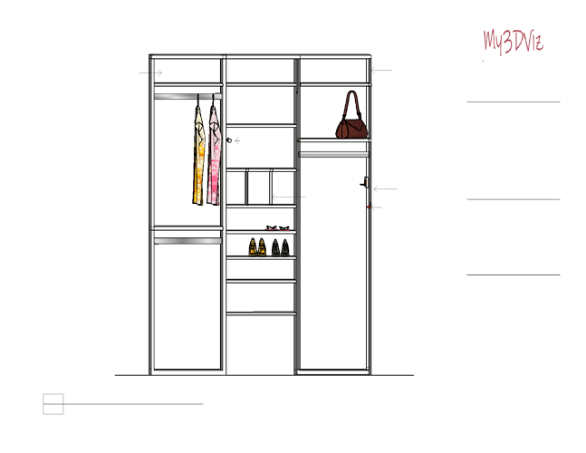

Any ideas why I would see text correctly in the print preview but not being in an png image export.

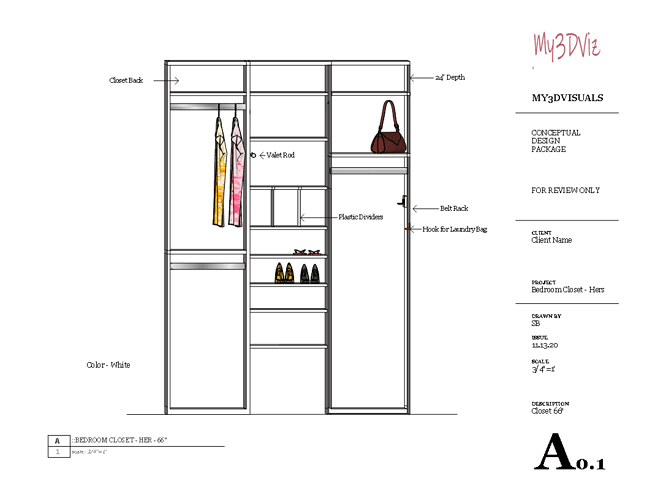

pdf export is fine.
What font? Points or height?
They all show as being points, this is in LO. Different leaders just randomly do not show up in the export.
I think I have seen somewhere mentioned that this is a bug.

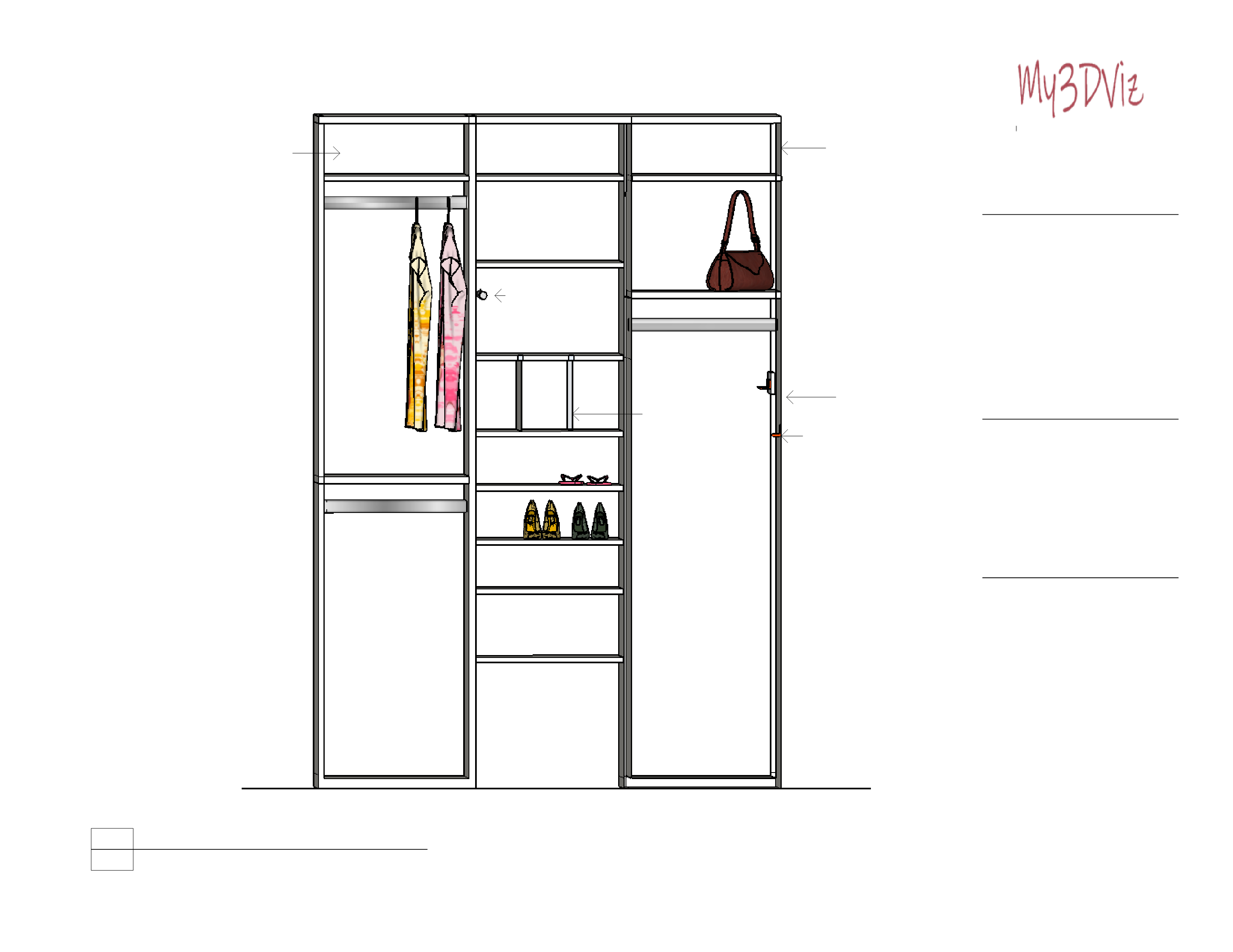

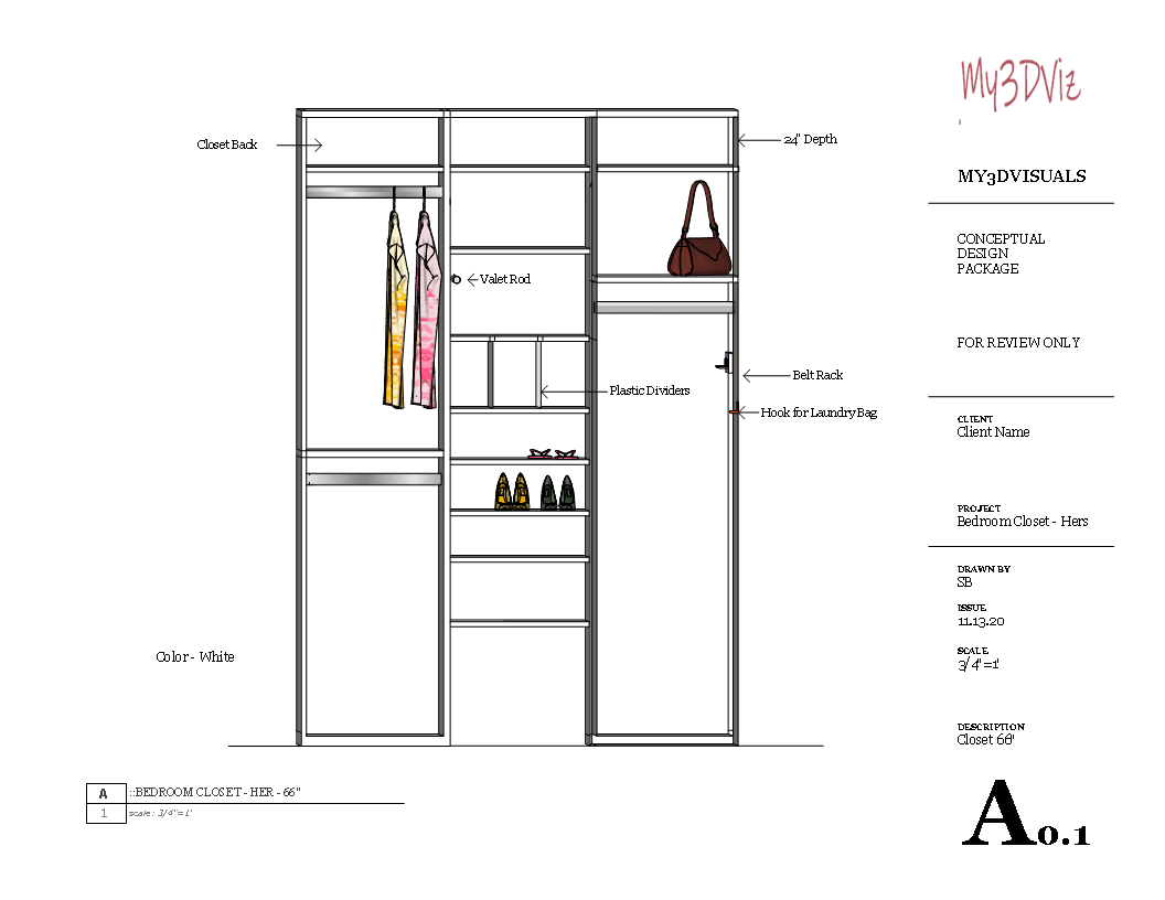

It may be a bug as @Anssi indicated although this is what I get when I export a png file from your file in LO2020.2.

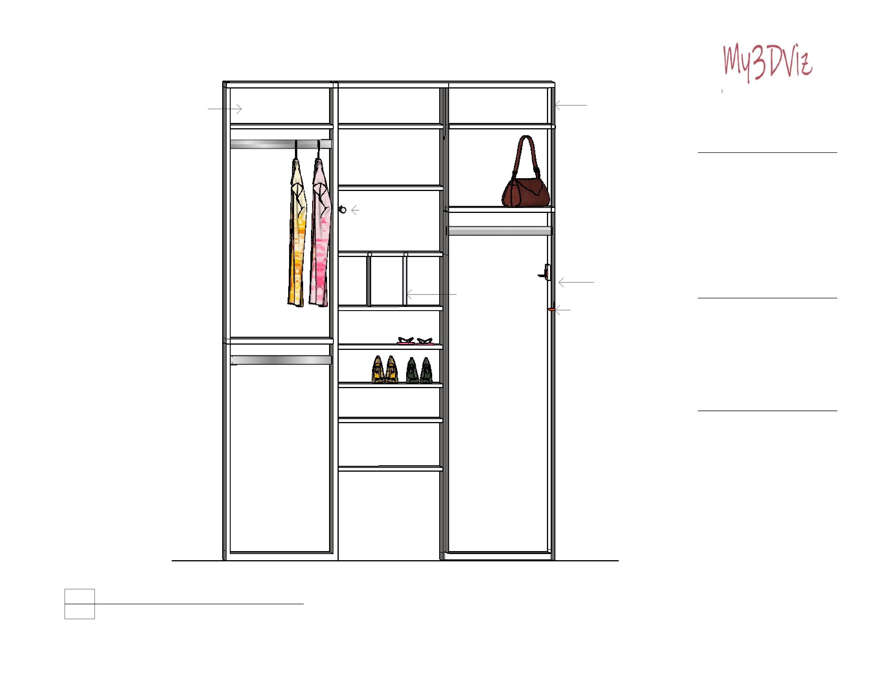

Do you get a different result if you first change the viewport rendering to Hybrid?

It seems to export correctly when I changed it to Hybrid. So that is a temporary solution, for now. Thanks!
Susan
That’s good. Using the Hybrid rendering will give you crisper looking line work so maybe you don’t want to think of it as a workaround.
