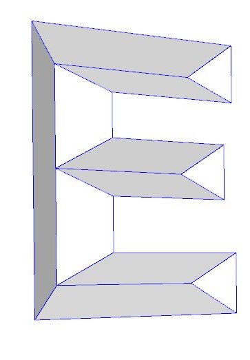

3D printed elements need support depending on many factors, trial and error, learning curve, etc. I’m experimenting with engraved text and am seeking a tool that will turn a normal SU text character into one that has a 45-degree draft applied to as shown in the pic rather than the standard, straight extrusion…

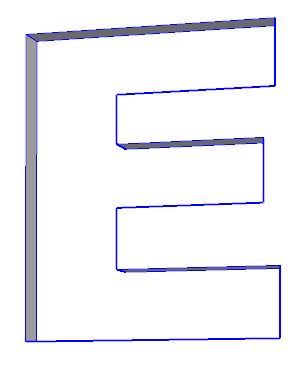

E - standard extrusion
I haven’t heard of any tools that will do that, but it would be pretty easy to do manually. Except with curved letters, “a” and “e” being two examples of that. A tool that does that would be pretty handy to have. Why don’t you Google it and see?
If you don’t have too many letters, you could use Scale about centre to shrink the front face of each letter to give a 45 deg bevel.
Fredo’s Round Corner plugin, Bevel option
