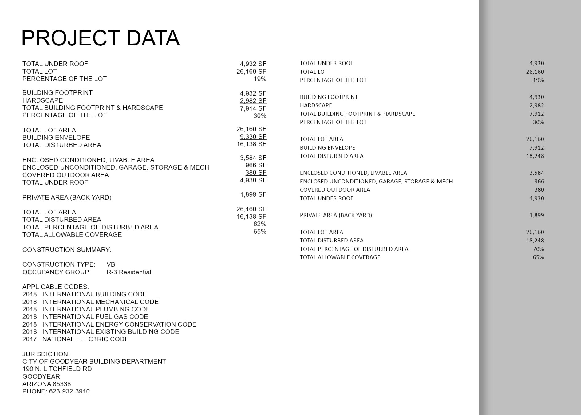

I am trying to streamline things and have a question about Tables in Layout.
Can a table be created without the cell outlines?
I know it sounds counterproductive, but I want to replace the Lot Coverage calculations that are manually edited with a spreadsheet that includes formulas. I don’t want the Grid, but I like the clean layout and formulas.
Select the table and in Shape Style turn off Stroke. You can turn off Fill, too.

Thanks, Dave!
I’ve wanted to fix this forever, but just didn’t take the time to do it.

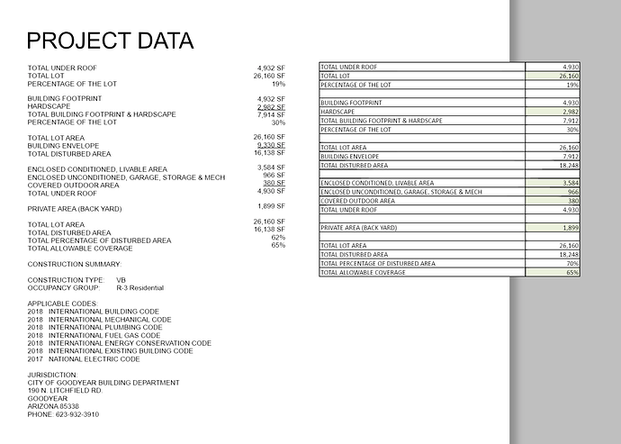

I tried that on the first table that I copied into LO, but had no luck.
It did work just as you said when I imported a saved .xlsx file.
Does that mean you copied from Excel and pasted into LayOut?
Yes. I grabbed the cells from Excel and pasted them in LayOut the first time vs importing a file.
