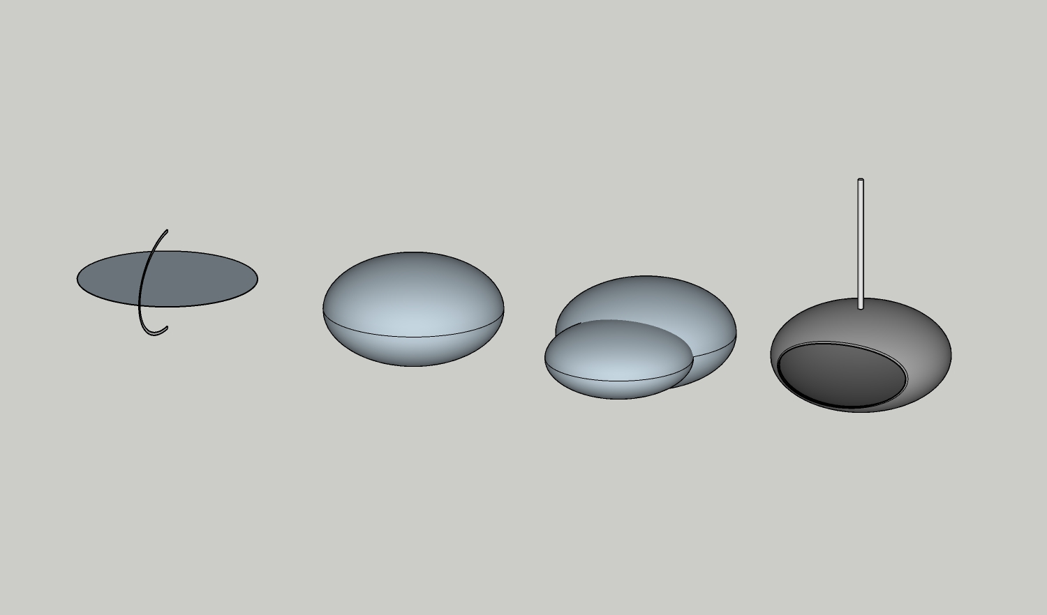

Hello, a quick way to do it :
- use follow me tool with a profile and a circle
- copy the outer shell and scale it along blue then green/red axes holding ctrl Key to keep it centered
- intersect with first one

Thanks very much Paul. Appreciate the help
