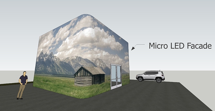

What if, when the technology gets cheaper, the house could be made of MicroLED screens? You could change your facade, so your house appeals to your tastes, with the click of a button.
(They are also the solution to the problem that we are living above our means, but are too comfortable to adapt our standard of living to the sustainable ration of resources that are available to us.)
I’m guessing you’re in the USA. If you suggested to a UK homeowner that their garden would be part of all the others (IE not a garden at all), they’d ‘tear you a new one’. (I believe that’s the phrase).
