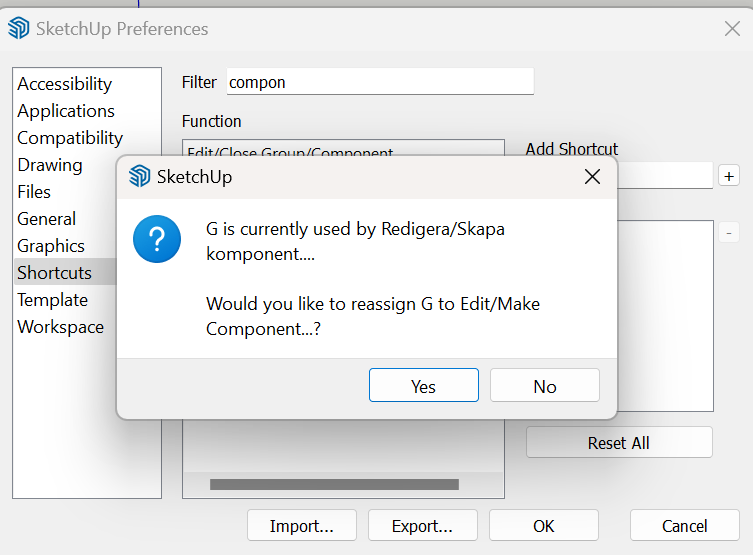

I had problems with licensing Su and finally sent the computer in for repair. When I got it back, no shortcuts work. (There are only a few shortcuts entered in the list) When I press “reset shortcuts” nothing happens.
If I try to change, I get a message saying that the shortcut is already used by the Swedish version of SU that I don’t have.

As for the Swedish part, the technicians happened to install SU in Swedish first but they removed it and installed in English instead. Somehow there seems to be a conflict between the shortcuts in different languages… but I don’t understand how to solve it.
I have tried completely new installation and repair. Shouldn’t be anything left of any old SU.

The file that stores shortcuts is at %LocalAppData%\SketchUp\SketchUp 2023\SketchUp\ and is called PrivatePreferences.json. Deleting that file ought to reset the shortcuts to the right ones for the language you’re using.
